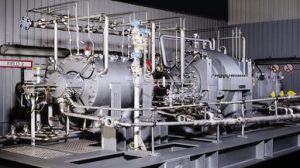

Siemens single shaft centrifugal compressors with horizontally split casings in the STC-SH series[/caption]
