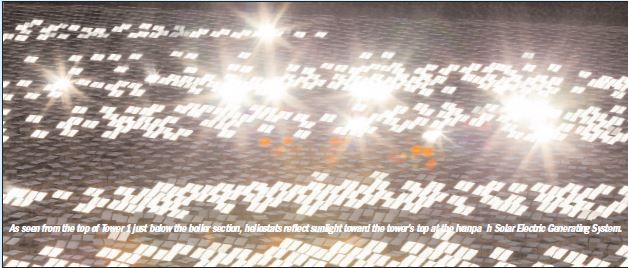

As seen from the top of Tower 1, just below the boiler section, heliostats reflect sunlight toward the tower's top at the Ivanpah Solar Electric Generating System[/caption]

On the technology side, this solar thermal plant uses computerized controls to monitor its array of heliostats as they follow the sun. Each mirror is roughly seven feet by ten feet and reflects sunlight up to the top of a central tower to heat water inside massive boilers and generate steam to drive turbines.
