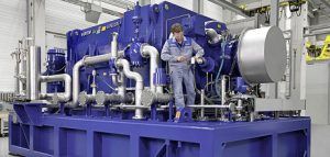

(Vorecon variable speed planetary gear can control the speed of pumps, compressors, and fans in the 1 – 50 MW power range.)

Steam turbine drivers were not considered because of the expenses for large condensers and demineralized water/steam supply. Therefore, electric drivers came into focus. For speed control of compressors either variable frequency drives (VFDs) changing the frequency of the electrical power supply or variable speed drives (VSDs) changing the gear output speed are available. Especially the spread of the operation points of the off-gas compressors demonstrates the capabilities of the hydrodynamic VSD.
The hydrodynamic torque converter with its turbine-like characteristic meets these requirements without oversizing the equipment. As the motor runs all the time at rated speed, the upper power limit given by the electric motor is almost constant and only de-rated by efficiency decrease at part load.
A VFD-driven motor would show decreasing output power at the same ratio as the motor speed decreases because the design is limited by the torque capability of the shaft and the rotor windings. Due to the climatic conditions between dust storms from the desert and corrosive saline atmosphere, the use of VFD would also have required large air conditioned buildings. While the footprint of a VFD system is determined by all the components like isolation transformer, harmonic filter, VFD, step-up gear, separate lube oil system, and cooler, the hydrodynamic variable speed planetary gear integrates all these functions in a single compact unit.
