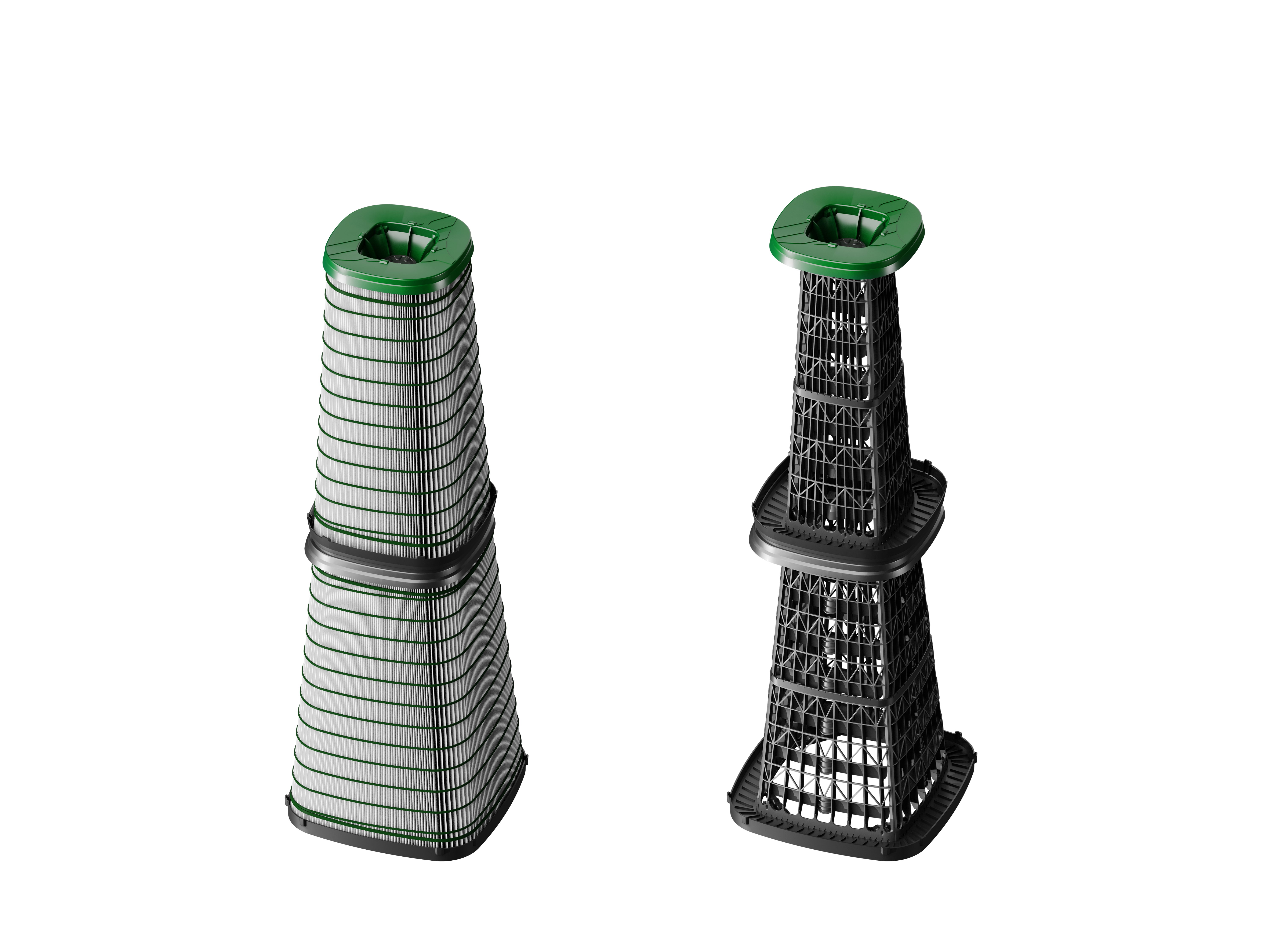

Figure 3 The TurboPulseTM filter featuring an innovative pyramidal cage construction with TurboVanes for improved airflow and pulsing
Static gas turbine filters, on the other hand, have evolved widely. Molded plastic components and modern manufacturing technologies have allowed for significant improvements in water handling, pleating, drainage, and sealing. By applying these technologies to self-cleaning filters, product performance could be dramatically improved. Enter TurboPulse™, a new product featuring molded plastic construction with an innovative pyramid shape. This product boosts performance and strength while offering 100% corrosion resistance and compatibility with existing conical-cylindrical installations. Its pyramidal shape allows for better water drainage, while the robust cage, featuring built-in aerodynamic TurboVanes (refer to Fig. 3), enhances airflow and pulsing performance. This not only reduces the initial pressure drop by up to 20%, but it also dramatically improves pulsing and reduces re-entrainment, extending the filter's lifespan.

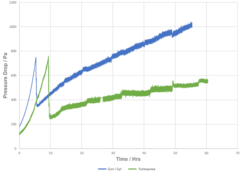

TurboPulse™ outperforms the typical conical-cylindrical filter in continuous pulse testing that simulates sandstorms (Fig. 4). Both filters utilize the same depth-loading media to highlight how the new construction improved cleanability. Typically, depth-loading media perform well in high-humidity conditions but struggle to maintain a stable pressure drop in such tests. This issue is usually addressed with surface-loading media. However, the enhanced cleanability of the new filter construction provides the cleaning performance of a surface-loading filter while retaining depth-loading benefits under high humidity conditions.
Figure 4 Comparative performance of a con-cyl and TurboPulseTM filter during a continuous pulse test. Success is established if the filter pressure stabilizes before the end of the test. Both filters were built with the same media and pleating technology.

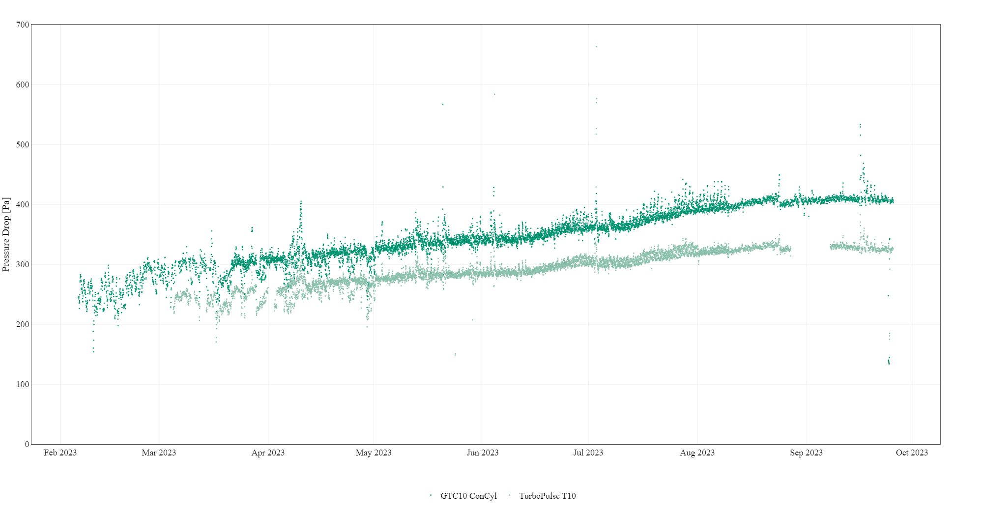

One of the first site installations featured two frame turbines running side-by-side. One unit was equipped with conical-cylindrical HemiPleat™ GTC10 filters, and the other with TurboPulse™ HemiPleat™ GTC10. Both filters were installed in February 2023, and the site has been monitored by the PowerEye™ predictive monitoring service. PowerEye™ has shown a significantly lower initial pressure drop for the TurboPulse™, with the pressure drop advantage increasing over time (Fig. 5).
Figure 5 Side-by-side baseload frames engines in Mexico. Engine 1 is running with a conical-cylindrical and Engine 2 is running with the TurboPulseTM. Filters were built with the same EPA (T10 efficiency) media with the sample pleating technology and are running at the same airflow. Performance data taken from Camfil’s PowerEyeTM monitoring system.
