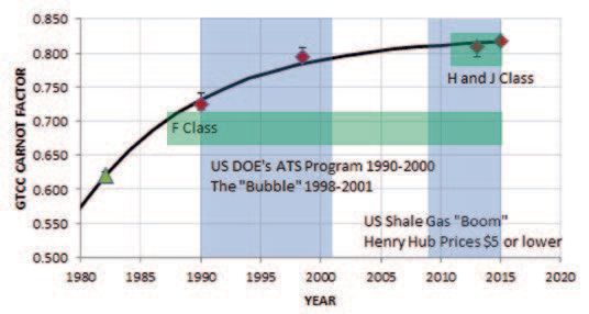

Figure 1: Historical improvements in GT technology.
In an earlier article published in Turbomachinery International 2016 Handbook (P. 24), the author provided a brief glimpse at future prospects for gas turbine (GT) combined cycle technology based on its historical evolution (Figure 1). Since then, major OEMs have announced “world records” and published performance ratings as high as 64% (net

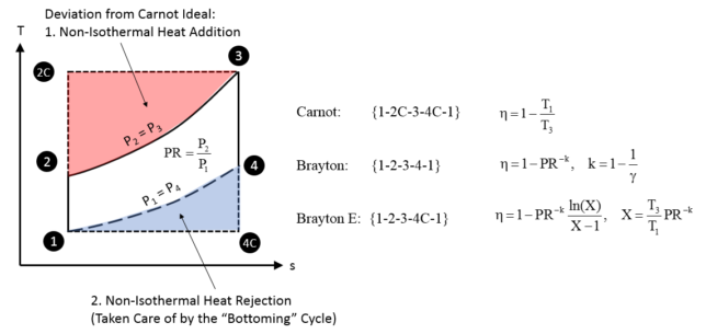

Figure 2: Gas turbine cycle hierarchy (Brayton E is the Enhanced Brayton cycle, which is the ideal proxy for the combined cycle)

The GT is an internal combustion engine. As such, it is a member of the larger family of heat engines. The starting point of any heat engine is the thermodynamic cycle that describes its basic operation. For the GT, it is the Brayton cycle.
Like all heat engine cycles, the Brayton cycle is a poor approximation of the thermodynamic ideal quantified by the hypothetical Carnot cycle. The cycle hierarchy is illustrated graphically on the temperature-entropy (T-s) diagram (Figure 2).
  • Carnot cycle is the theoretical maximum imposed by heat source and sink temperatures, T3 and T1, respectively
  • Next comes the air-standard, ideal Brayton cycle, whose performance is controlled solely by the cycle pressure ratio, PR
  • At the bottom lies the real cycle beset by hardware imperfections, which, strictly speaking, cannot be depicted on a T-s diagram.
The deviation of the ideal, air-standard Brayton cycle from the Carnot cycle can be quantified by the two, roughly triangular areas in the T-s diagram of Figure 2: heat addition imperfection quantified by the area {2-2C-3-2}; and heat rejection imperfection quantified by the area {1-4-4C-1}.
The second imperfection can be rectified to a great extent by a second thermodynamic cycle via waste heat recovery. The waste heat in question is the energy content of the GT exhaust (state-point 4). This is the thermodynamic driver
behind the Brayton-Rankine combined cycle, wherein the ST Rankine bottoming cycle makes use of the GT exhaust heat to generate additional power. The ideal combined cycle is essentially an enhanced Brayton cycle represented by the area {1-2-3-4C-1}.

The current iteration of the machines in each class have TITs up to about 50°C higher than the introductory values. The next generation of gas turbines is likely to be a 1,700°C TIT machine. Basic thermodynamics tells us the theoretical upper limit of combined cycle efficiency for a given TIT (the enhanced Brayton cycle efficiency in Figure 2). State-of-the-art technology can only achieve a fraction of that upper limit. That fraction is known as the technology factor (TF).
In the 2016 TMI Handbook article (Figure 1), TF for H and J class GT combined cycles was around 0.82. This is a testament to the engineers designing these power plants and the equipment therein. The high value of TF and its asymptotic trend (a line that approaches a curve but never touches) are indicative of the cost and difficulty involved in achieving further gains.

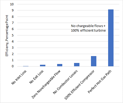

Figure 3: Gas turbine Brayton cycle entitlement stairsteps

In order to investigate where the opportunities for improvement lie, a sample calculation is done. An advanced class gas turbine with 1,600°C (2,912°F) TIT and cycle pressure ratio of 22:1 (simple cycle efficiency of 41.4%) is taken as the starting point.
For PR = 22, the theoretical efficiency entitlement is 58.7% (with zero losses, isentropic components and no turbine cooling). Going through the elimination of loss mechanisms in an orderly fashion, one ends up with the stairstep chart in Figure 3. The hot gas path provides the largest opportunity for improvement. The improvements in Figure 3 add up to about 12%. Thus, the maximum possible efficiency is 53.4%. The difference between 53.44% and 58.7% is due to the exergy destruction (irreversibility) in the combustor. There is nothing that can be done to alleviate this fundamental loss.
Efforts to minimize the hot gas path losses include:
  • Reduction of cooling flows materials (superalloys, ceramic matrix composites), casting techniques (directionally solidified, single crystal), film and effusion cooling, thermal barrier coatings
  • Brush and honeycomb seals, and reduced clearances
  • 3D CFD for airfoil profiles and vane/blade geometries.
Technologies that can help in this endeavor are additive manufacturing, faster computer processing, data analytics and adaptive controls. The goal of combustor improvements is to achieve stable, premixed combustion for low NOx at 1,700°C. The enabling technology is axial fuel staging. The concept can be thought of as reheat or sequential combustion without a turbine stage between the combustors. The technology also enables the turndown of the GT to low loads while staying emissions-compliant.
