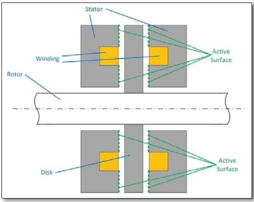

When using AMBs, a distinction must be made between static (zero or low frequency) and dynamic (high frequency) load capacity. Similarly, there is a distinction between low frequency and high frequency stiffness and damping. The static load capacity of the actuator in a magnetic bearing is defined by the surface area of the stator pole faces (Figure 1) together with the maximum achievable flux density (also known as the saturation flux density) for the material in the disk and stator parts. To increase the static load capacity, either the area or the flux density must be increased.
Figure 1: Schematic of an axial AMB showing the active working area of the stator
Figure 1: Schematic of an axial AMB showing the active working area of the stator[/caption]
The materials typically used for high-flux-density machines are not available in bulk solid form; consequently, manufacturing thrust disks from these materials is challenging. It is more straightforward to increase the surface area of the stator pole faces.
Surface area can be increased using one of several methods. The first is to increase the outer diameter (OD) of the thrust disk. While a simple solution, there are trade-offs. The diameter of the disk will be limited by its burst speed, which is primarily a function of its operating speed and yield strength. This means that compromises must be made between the mechanical properties of the disk material and the magnetic properties. In addition, a large diameter disk (typically located at the shaft end) is not desirable from a rotordynamic perspective. It will drop the natural frequency of the lateral modes, thus reducing the separation margins for higher order modes. Large diameter disks may also introduce lateral modes dominated by the disk mode; these modes can be analyzed only with full Finite Element Analysis techniques. Finally, the larger thrust disk increases the windage losses between the thrust collar and axial actuator. While this may not limit the achievable diameter, it will impact overall design.
Surface area can also be increased by reducing the winding volume. The winding slot geometry is constrained by the achievable current density in the winding, which is governed by the ambient temperature of the machine, the rating of the insulation material and the cooling paths to the exterior. Maximum use of the winding slot must be made, and for maximum efficiency, rectangular crosssection wire is typically used.

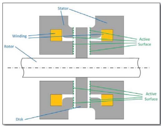

A third way to increase surface area is alternate geometries. The classic thrust bearing design uses either a U-shaped (Figure 1) or E-shaped section in the stator. Profiled poles allow the dead space associated with the winding slot to be avoided (Figure 2). A multi-pole stepped thrust disk design reduces the thickness for a large OD disk and is paired with a similarly profiled stator. This improves the stress and natural frequencies in the disk, allowing unit loads up to 704 kN.
