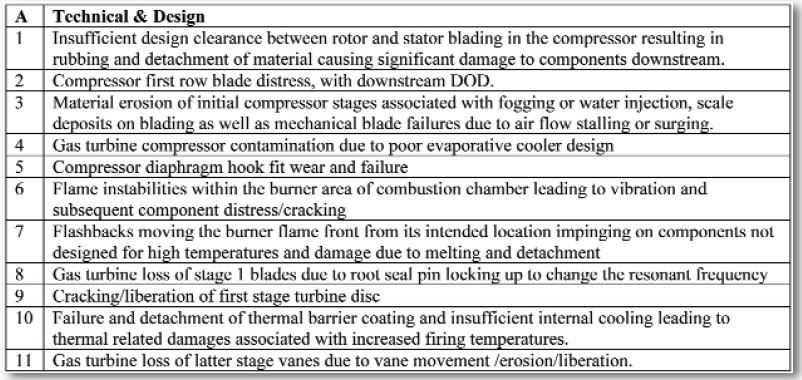

Table 1: Summary of frequent failures associated with design deficiencies[/caption]
Table 1 lists common insurance claims that are associated with design deficiencies. Failure 1 constitutes a clear example of failures that could be detected during short-term validation. Failures 2, 3, 6, 7 and 10 could happen during either short or long term validation. It is worth mentioning that 6 and 7 could be a non-issue until certain ambient conditions, fuel composition or performance deterioration degrades to the point where combustion instabilities are triggered. Failure 3 could be separated into two different scenarios with two different trigging mechanisms. Stalling and surge could happen early if the design and the surge margin are marginal but their occurrence is also affected by long-term compressor fouling. Erosion and scale deposits are typically developed during long-term operation. Failures 4, 5, 8, 9 and 11 can mainly be detected during long-term validation.

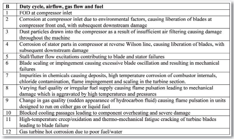

Table 2: Summary of frequent failures associated with duty cycle[/caption]
For Table 2, foreign object damage (FOD) can be detected soon after starting short-term validation, with the exception of an uncommon case that the foreign object is held in position until released. Failures 2, 3, 4, 6 and 11 can mainly be detected during long-term validation while 5, 7, 8, 9, 10 and 12 could happen during either short- or longterm testing. Failure 10 could happen in short-term, though, if the cooling passages were clogged during manufacturing of the failed component, but it will typically correspond to long-term validation results in cases where the clogging is induced by dust or rust, unless poor system cleaning has been applied during commissioning.
