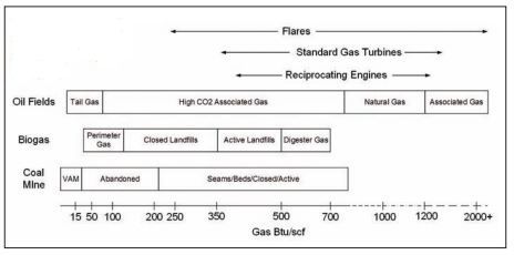

The decision to dispose of or use a waste gas stream is typically determined by evaluating criteria such as heating value, cleanliness, corrosiveness and availability. The heating value of the gas is a measure of the fuel’s energy density (Figure 1).
Figure 1: Operating ranges and typical waste gas energy densities
Figure 1: Operating ranges and typical waste gas energy densities[/caption]
It determines whether the fuel can operate conventional technology without supplementing it with a more energy dense fuel. In addition, the heating value determines flow requirements for the machine. The heating value limit is set at 300 BTU/scf and above for current reciprocating engines and gas turbines technologies.

Typical waste gas producers include biomass, landfills, coal mines and associated petroleum gases (APG) from oil & gas operations. The gases from these processes usually have heating values below that which current technology can support (300 BTU/scf). Because current waste gas utilization projects use conventional reciprocating engines or gas turbines as their prime mover, many of these projects remain uneconomical.

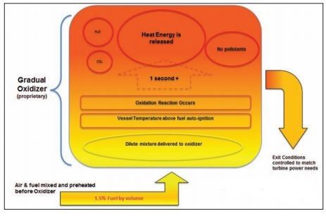

Gradual Oxidation technology was engineered as an alternative to conventional combustion to allow gas turbine and reciprocating engine manufacturers to produce power from previously unusable low-energy sources. The gradual oxidation reaction is fundamentally different from combustion in that it occurs at a lower temperature (2,200°F), lasts longer (seconds) and is flameless. It offers flexible fuel capabilities, lower emissions and the destruction of volatile organic compounds (VOC).
Figure 2: Gradual oxidation reaction cycle
Figure 2: Gradual oxidation reaction cycle[/caption]

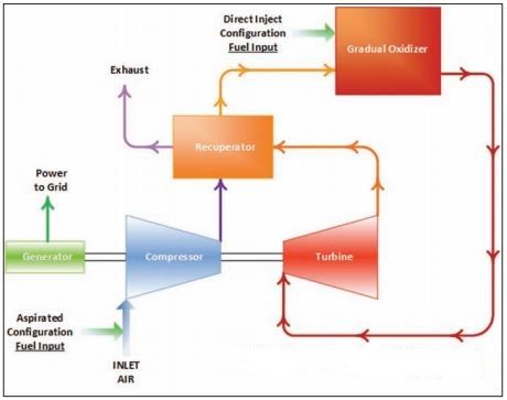

Gradual Oxidation be gins with the mixing of fuel gas with air to a 1.5% fuel-to-air ratio. This mixture is pressurized and introduced into the gradual oxidizer, which is heated above the auto-ignition temperature of the fuel. At this temperature, a chemical reaction releases heat ener gy. A prime mover can harness that energy to turn a generator (Figures 2 & 3).
Figure 3: Flow diagram for power production using gradual oxidation
Figure 3: Flow diagram for power production using gradual oxidation[/caption]

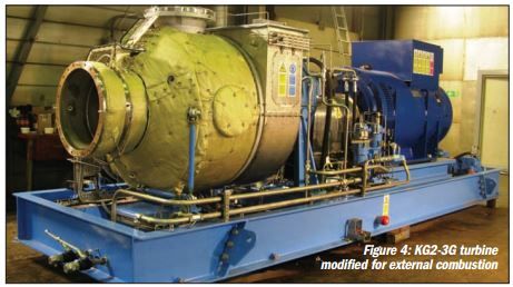

A 1.85 MW pilot project is ongoing that pairs Gradual Oxidation technology with Dresser-Rand’s KG2-3G gas turbine. The KG2-3G has improved performance and lower emissions than previous generations of the KG2, as well as 26% efficiency and less than 25 ppm NOx using a dry low NOx combustor. An externally fired version was implemented by diverting the airflow from the compressor to an external combustor and returning it to the gas turbine.
The gradual oxidizer is a further step in this evolution as it is a one-for-one replacement for the external combustor. The gradual oxidizer adds heat to the air from the compressor prior to expansion through the turbine (Figure 4).
Figure 4: KG2-3G turbine modified for external combustion
Figure 4: KG2-3G turbine modified for external combustion[/caption]
