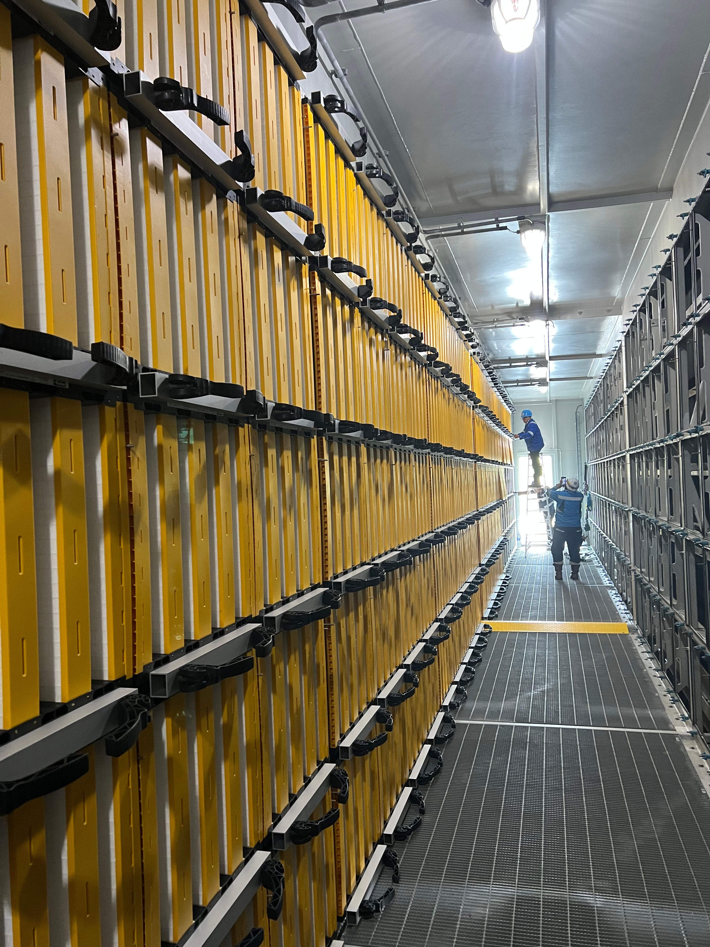

Simulating with typical PM10 air quality data, the removal of a single filtration unit from the filter house, which may have up to 700 filter elements, can leave an open-area gap of 0.35 m2 in an otherwise HEPA-grade system. Under standard conditions, approximately 1.5 kg of material passed through this gap in the filtration system over 8,000 hours, approximately a year of gas turbine operation. The entirety of the filter house running with HEPA filters in standard conditions without any bypass in comparison would only allow approximately 100 g of material through over the same period.
Clearcurrent ASSURE - Advanced gas turbine HEPA filter house

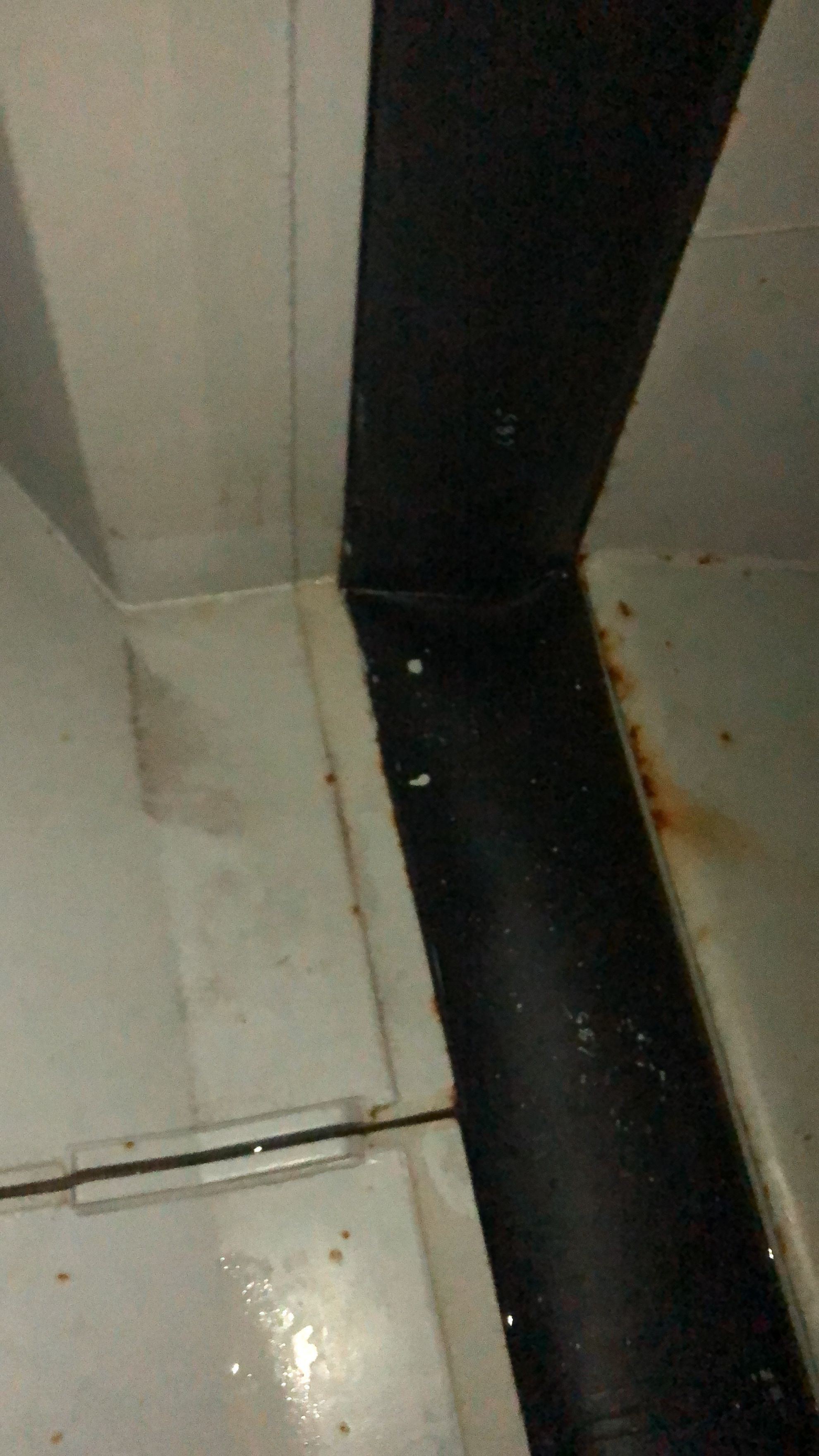

A recent example of how this affects the gas turbine is a multi-unit advanced gas turbine power plant in Asia outfitted with a filtration system comprising a pocket pre-filter and E10 vCell downstream HEPA filters. Downstream from the HEPA filters were gaps in the modular construction of the filter house and transitions that allowed water and air to be sucked in—a total open area for filtration of approximately 250 m2.
The operator noticed a drop in the machine's performance. Subsequent inspections revealed the turbines were fouled and even had pitted and corroded compressor blades. Further investigation of the filtration system, including water-spray tests, revealed that, although the filters were intact and installed correctly, construction errors had left gaps in the roof of the filter house. Since cleaning can't restore pitted and corroded blades, the operator had to replace some of the rotors of the compressor section.
Signs of construction errors, leaks behind HEPA filter stage
