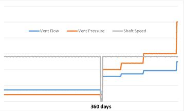

Primary vent leakage trend[/caption]

A set of dry gas seals was installed and commissioned in a new application which continued to operate for over a year without incident. The compressor was then shutdown for an issue unrelated to the dry gas seal. However, shortly after the restart, the drive end primary vent transmitter recorded a step change in leakage. Although the leakage was high, it remained below the trip value and the compressor continued to operate. Approximately 40 days later the leakage value spiked again this time initiating a shutdown. The dry gas seals were subsequently removed and sent to the factory for examination.
