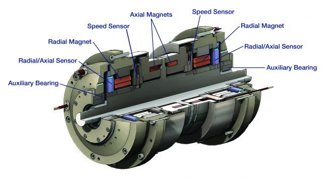

Schematic of a typical turboexpander active magnetic bearing  (AMB) system

Expanding a retrofit to include the mechanical components as well as the controller allows optimization of the bearing windings to make full use of the controller’s power-amplifier capabilities. Retrofitting with specialty hardware, such as sealed or canned stators and sensors and corrosion-resistant auxiliary bearings, can increase the robustness of the AMB system. The replaced hardware typically includes magnets, position sensors, speed sensors, and auxiliary bearings, thus eliminating any controller design restrictions. New constraints are introduced, however, to the AMB stator hardware. The stators must fit within the same envelope as the existing bearings, work with the existing pressure penetrator and cable structure, and work with the existing hardware.
The stator parts replaced on the turboexpander under discussion included AMBs and auxiliary bearings for two radial bearings and one thrust bearing. The bearing envelopes were consistent with the original hardware, maintaining a radial bearing diameter of 150 mm, radial bearing length of 66 mm, and axial bearing disk diameter of 380 mm. The system was successfully run to close to full speed though not with full density gas. The correlation of the transfer function measurements and the vibration response plots from the test with rotordynamic modelling established confidence in the model.
