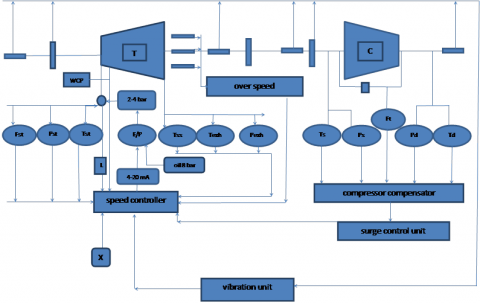

Poor response for anti-surge protection system
Anti-surge protection system is a very important part of compressor but it is not presented in anti-surge valves only but it contains a several devices that integrate all together to give an output which is the safe protection set-point for machine.
Anti-surge protection system has several points of control in other words its degree differs according to number of parameters measured and integrated processed data together to obtain the final result which will be applied as an action.
