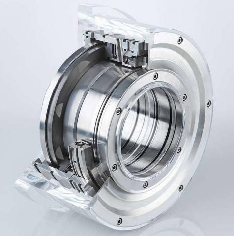

Seal gas on centrifugal compressor shaft-end seals is deployed for applications ranging from
localized warming of the contaminated drain area of oil seals in refrigeration service to protection of close clearance sealing faces of dry gas seals.

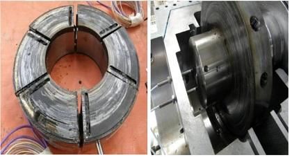

We have seen uncontrolled venting exceed the breakaway torque required to break loose and spin a motor/gear/centrifugal compressor string even without lube oil supplied to the bearings. The result was disastrous, as shown below.
The location of the vent and vent rate is critical. The team should avoid selecting a vent location that would allow reverse rotation of the unit, even if the oil system was activated. This is because certain bearing designs incorporate leading edge groove technology as shown in the above thrust bearing that will not develop the proper oil film in the reverse direction. Additionally, certain dry gas seal technologies utilize sealing face lift technology that will only operate in the forward direction.

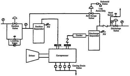

So again, it is the responsibility of the site rotating equipment engineer to assure the commissioning team is properly trained and that a detailed procedure is developed when pressure testing process loops that include centrifugal compressors. The following is a typical process loop.

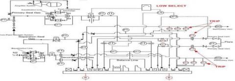

As the majority of new applications utilize dry gas seals, commissioning of the seal gas is one of the key prerequisites for the commissioning team to perform to avoid damage to the dry gas seal faces. The following is an example of a dry gas seal support system.

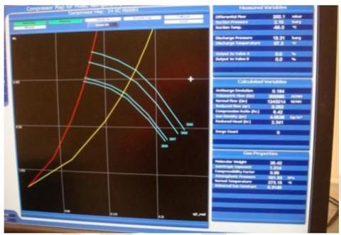

·Spurious trips during restart or bogdown trips during recycle valve opening due to increased compressor horsepower as a result of off design process gas.
The following illustrates the results of an LNG MR loop operating with a higher than design MW gas. As shown, the compressor discharge pressure was significantly higher than predicted.
A series of flaring and replenishment of loop process gas was required to restore gas properties to their design levels, allowing the plant to produce on spec. LNG.

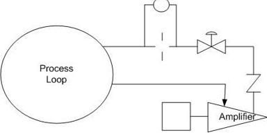

The solution to these problems is a device that takes its supply from the process loop then slightly raises it to the required seal gas differential pressure.
Using PV = nRT, the increase in pressure in the loop when the suction is fed from the loop, is only a function of the temperature rise. T
he loop pressure will continue to increase to the external source pressure if left intact long enough. When the supply to the amplifier is connected to the loop the loop remains at the settleout conditions, while not introducing incompatible seal gas into the loop. So a simple seal gas booster system, commercially know as an Amplifier System, is a readily available product that solves all the above problems.
