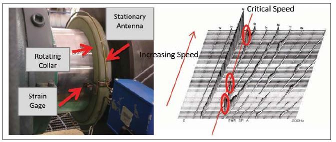

Figure 1: Torsional Telemetry System Components              Figure 2: Excitation of a Torsional Critical Speed
In systems without a gearbox, the typically installed lateral shaft or casing vibration probes are not sensitive to torsional vibration. In most cases specialized instrumentation must be used to capture this type of data. One common method involves the use of a strain gage telemetry system, as shown in Figure 1. Several other methods of obtaining this data exist, including the use of a torsiograph or encoder on the outboard end of the motor or driven equipment.
However the data is obtained, the calculated torsional critical speeds can potentially be confirmed during startup or shutdown events, as depicted in Figure 2. In this illustration, a torsional critical speed is evident as it is traversed by relatively low-level energy generated at several orders of running speed.
This figure illustrates the concept that the train may need to tolerate some level of critical speed excitation during operations involving a speed change, even if the subject mode is not excited at nominal speed. In addition to common mechanical excitation sources (including the driven equipment), motors and variable frequency drives also produce excitation energy that can interact with the critical speeds.
The type of data shown in Figure 2 can be used to assess the damping present in the system (by observing the amplification factor of the response peaks). Additionally, dynamic torque or stress levels obtained from the test data can be compared to rotordynamic predictions.

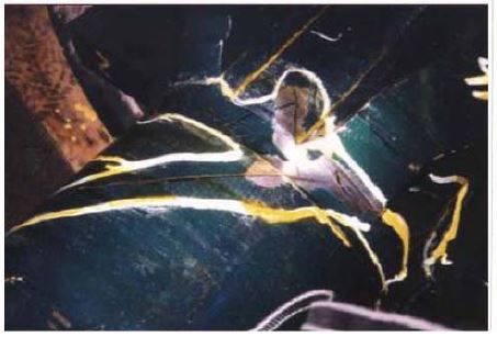

Figure 3: Typical Webbed Shaft Failure[/caption]
Figure 3 illustrates a typical torsional failure, in which a series of forty-fivedegree cracks are evident in the shafting and webs. In many cases, the cracks form at the base of the webs, and progress into the shafting itself.

Figure 4 illustrates how the stress can intensify near the ends of the web bases, which is consistent with the failures shown in Figure 3. The initiation and propagation of these types of cracks can be significantly influenced by torsional resonances, excessive web flexibility, and stress concentration factors.
Special attention should be paid to the web-shaft interfaces to ensure that any necessary welds are properly dressed, and that the geometry is optimized in this area to diminish stress concentration effects, especially at each end of the webs.
