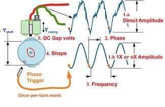

Single plane transducers only display motion along the longitudinal axis of the transducer.

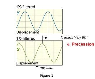

Orthogonal transducers not only display motion along the longitudinal axis of each transducer, but when combined as a pair or XY coordinates in a Cartesian coordinate system form the shaft orbit, displaying the full dynamic motion in the XY radial plane. Refer to Figure 1.
Vibration signal characteristics
1. Amplitude:
- Overall / Direct
- nX Filtered
2. Phase
3. Frequency
4. Form / Shape (XY pair) 5. Radial / Axial Position
6. Precession

An orbit can be used to determine the direction of precession of the rotor. The Phase Trigger mark on the orbit, the blank/dot sequence on the orbit plots, shows the direction of increasing time, which is the direction that the shaft is moving (the direction of precession).
Once the Phase Trigger mark sequence is determined, it will show the direction of increasing time. This is the direction that the rotor moves in the orbit, regardless of the direction of rotation. The direction of precession can be compared to the direction of rotation to determine whether the precession is forward (vibration precession direction same as rotational direction) or reverse (vibration precession direction opposite rotation direction).

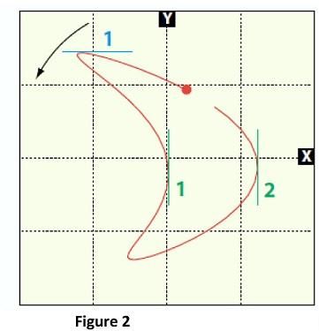

On complex orbits, the rotor may undergo forward precession over part of the orbit and reverse precession over another part of the same orbit. Refer to Figure 2.
Starting at the phase trigger marker and moving around the orbit in the "blank to dot" direction (CCW in this example), count the number of positive peaks that occur in the X direction and in the Y direction. In this example, the X transducer sees two positive peaks in (one is smaller than the other), and the Y transducer sees only one positive peak. The X:Y frequency ratio is 2:1, with vibration components of 2X and 1X respectively. As seen in this example, the shape of an unfiltered orbit can provide important information about the frequency content of machinery vibration.

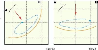

Shape can also provide clues to the presence of excessive radial loads that may exist. High radial loads tend to push the rotor to high eccentricity ratios in a fluid-film hydrodynamic bearing. The oil film that supports the rotor produces very high spring stiffness at high eccentricity ratios. This stiffness is highest in the radial direction and lowest in the tangential direction.
Figure 3 shows two unfiltered orbits with high radial loads. Note that the two machines turn in opposite directions (black arrows). Both orbits display remarkably similar shapes; in fact they are nearly identical when corrected for rotation direction. The arcs indicate the location of the bearing wall, and the red arrows indicate the likely direction of the applied radial load.
