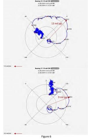

W501D5A Industrial Frame Gas Turbine / Generator - Change in Direct and 1X
Vibration Due to Thermally Induced Rotor Bow
Figure 5
13 mil pp
9 mil pp
Figure 6
• Bearing #1 (Turbine Exhaust); X and Y Probe Polar Plots
• Initial Post Outage Startup, Rub Initiates Below 2nd Critical Speed
• High Vibration Amplitudes through 2nd Critical Speed (Red Dashed Arrow)
• Gray Arrow Shows Change in 1X Vibration from 3600 rpm, No Load to 105 MW
• Frictional Heating of the Rotor Due to the Rub Near Bearing #1 (Turbine Exhaust End) is Bowing the Rotor Resulting in Ever Increasing 1X Vibration Amplitudes

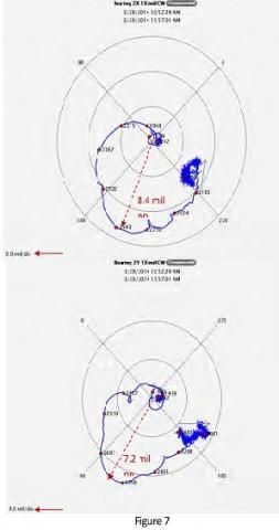

Figure 7
• Bearing #2 (Turbine Inlet); X and Y Probe Polar Plots
• Change in Vibration Due to Thermal Rotor Bow (Rub) Has Less of an Effect At Bearing
#2

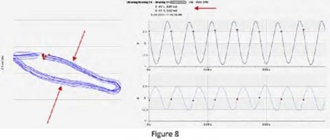

Figure 8
• Bearing #1 (Turbine Exhaust End); Steady State @ 105 MW Load
• Direct Waveform Compensated Orbit / Time base Data Plot
• Red Arrows Indicate Plane of Orbit Pre-Loading (Rub)
• Vibration Amplitude Approaching 9.5 mil pp
• Unit Tripped Due to High Vibration at Bearing #1

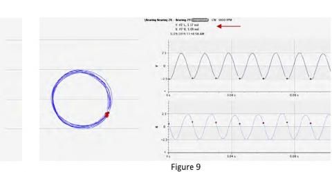

Figure 9
• Bearing #2 (Turbine Inlet End); Steady State @ 105 MW Load
• Vibration Amplitude Approaching 5.2 mil pp When Unit Tripped
• Thermally Bowed Rotor is Driving a Very Circular Vibration Response

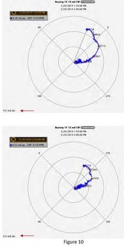

Figure 10
2nd Startup Attempt (Hot Startup)
Unit Tripped Due to High Vibration While Trying to Pass Through the 2nd Critical
Speed
High Vibration Due to Thermally Bowed Rotor

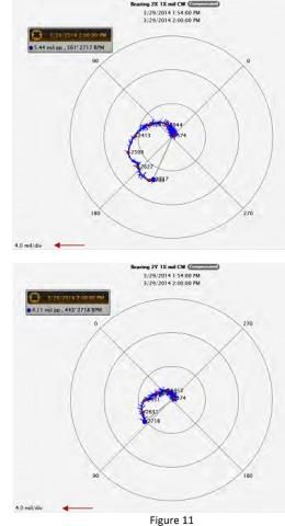

Figure 11
Speed

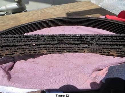

Figure 12
• Coked Exhaust End (Turbine Section) Labyrinth Seals
• Source of the Rub
• Source of the Thermal Bow
