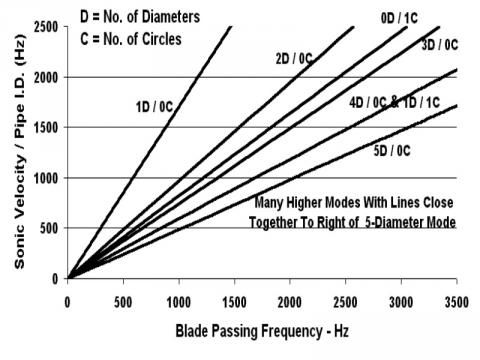

Piping Noise Resonance - Transverse Gas Modes Inside Pipes
f = Constant x V / D
where:
f = Natural Frequency (Hz)
V = Acoustic Velocity (ft/sec)
D = Pipe Inner diameter (ft)
For First Mode (One Diameter)
f= 0.59 (V / D)
Figure 1 has a plot for modes using the constants plotted with sonic velocity Vs blade passing frequency.

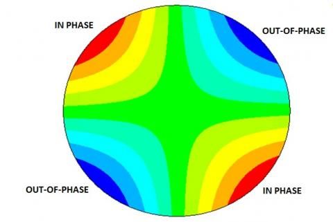

In Figure 2 the 2-diameter mode shape is shown.
Figure 1. Lines of Resonance for Gas Transverse Modes Within Long Circular Pipes.
Figure 2. Two-diameter Gas Mode Shape - Four Radial Node Lines

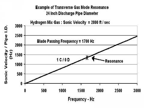

Figure 3. One-Circle Mode Resonance for Discharge Pipe from Compressor Handling Low Mol Weight Gas.
Lower mol weight gases are more likely to have resonance of the lower modes that are more easily excited by blade passing frequency.
