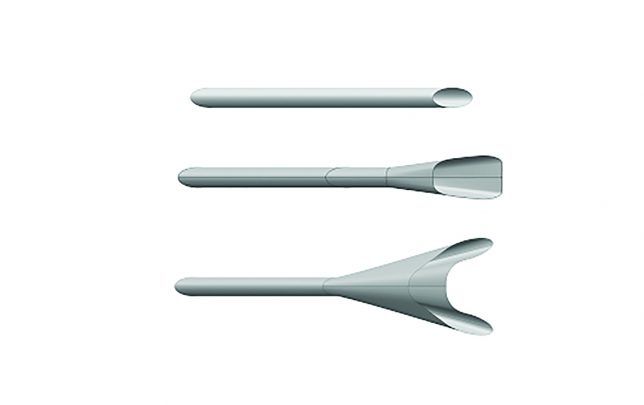

Film cooling effectiveness is improved using fan-shaped holes to direct the flow of the air jets instead of conventional cylindrical holes. In addition, CFD simulation used a technique known as double jet film cooling, as well as nekomimi (Japanese for cat’s ears, reflecting the visual appearance of the holes) film cooling technology (Figure 1).
Figure 1: Film cooling hole geometries: cylindrical (top), fan-shaped (middle), nekomimi (bottom)

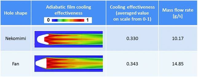

The computational domain used to test the cooling effectiveness of different shaped holes consists of a main cross-flow duct and a plenum for the coolant supply, connected by the film cooling hole. The walls at the lateral sides are defined as symmetry planes in order to represent a row of film cooling holes, typical for GT applications.
As illustrated in Figure 2, a similarly sized nekomimi hole results in about equal film cooling effectiveness at a lower mass flow rate compared to the fan-shaped hole. Note that on the normalized scale from 0-1 that is typically used for cooling effectiveness, red=1 (better) while violet=0 (worse). The result has been cooling improvements of 200% to 300% in the nekomimi designs over reference shaped holes.
Figure 2: Comparison of cooling effectiveness and mass flow rate for a nekomimi versus fan-shaped hole as shown in STAR-CCM+ (by CD-adapco)

These degradations can be remedied by using a shaped-hole exit instead of a round hole, which leads to reduced momentum flux ratio between the coolant and cross flow at the cooling-hole exit (caused by the flow deceleration inside the diffusor part of the shaped hole). A Coandă effect (the tendency of a fluid jet to stay attached to a convex surface) facilitates flow hugging the wall behind the hole. To reduce the undesirable mixing between the coolant and the hot gas, double jet film cooling (DJFC) technology was introduced.

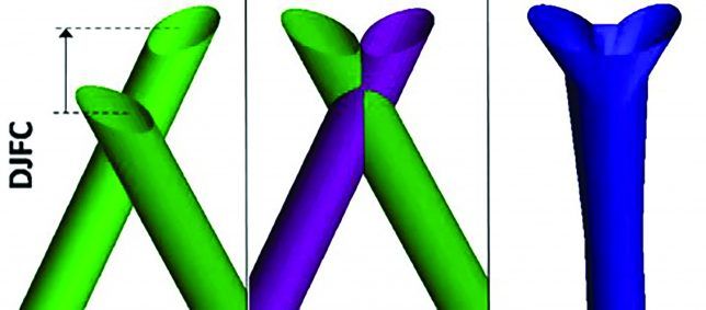

The nekomimi technology takes this a stage further by combining the two cylindrical holes of DJFC within a single hole design to overcome air supply inefficiency. This was achieved by shifting the holes of the DJFC configuration to the same streamwise position (Figure 3, Step 1), uniting both holes (Figure 3, Step 2) and replacing the two supply holes with a central one (Figure 3, Step 3).
Figure 3: Nekomimi design concept: a) Step 1 (DJFC) b) Step 2 c) Step 3 (nekomimi)
