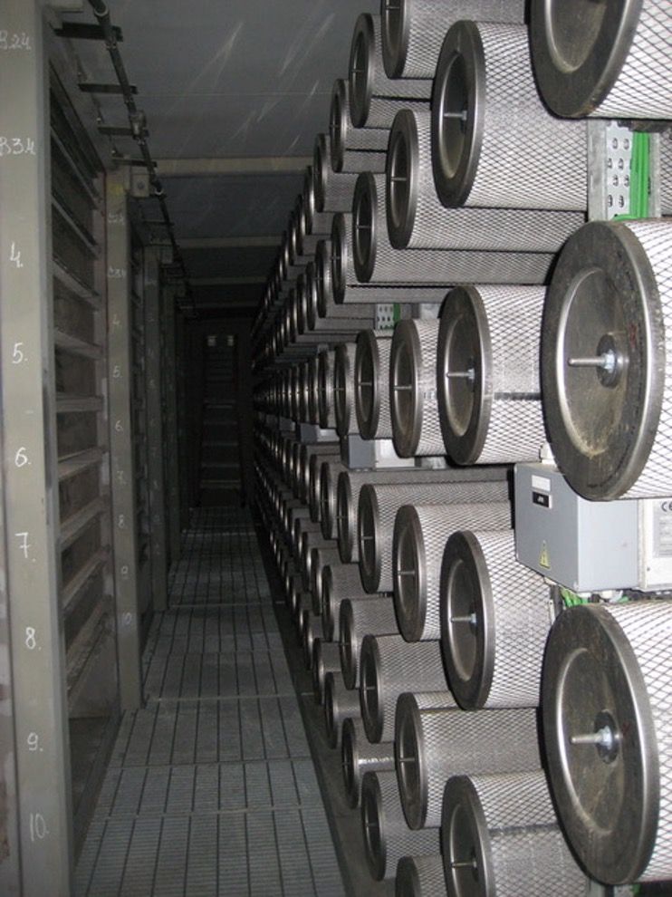

Typical pulse cartridge filters installed in a land-based GT-HD housing.

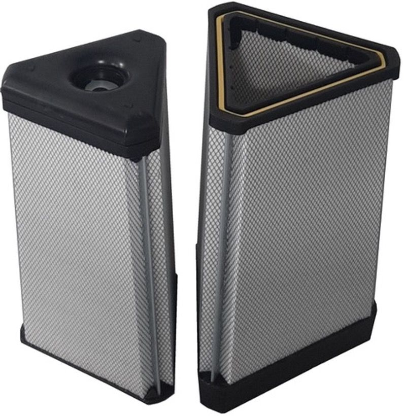

Geometry pulse cartridge filter

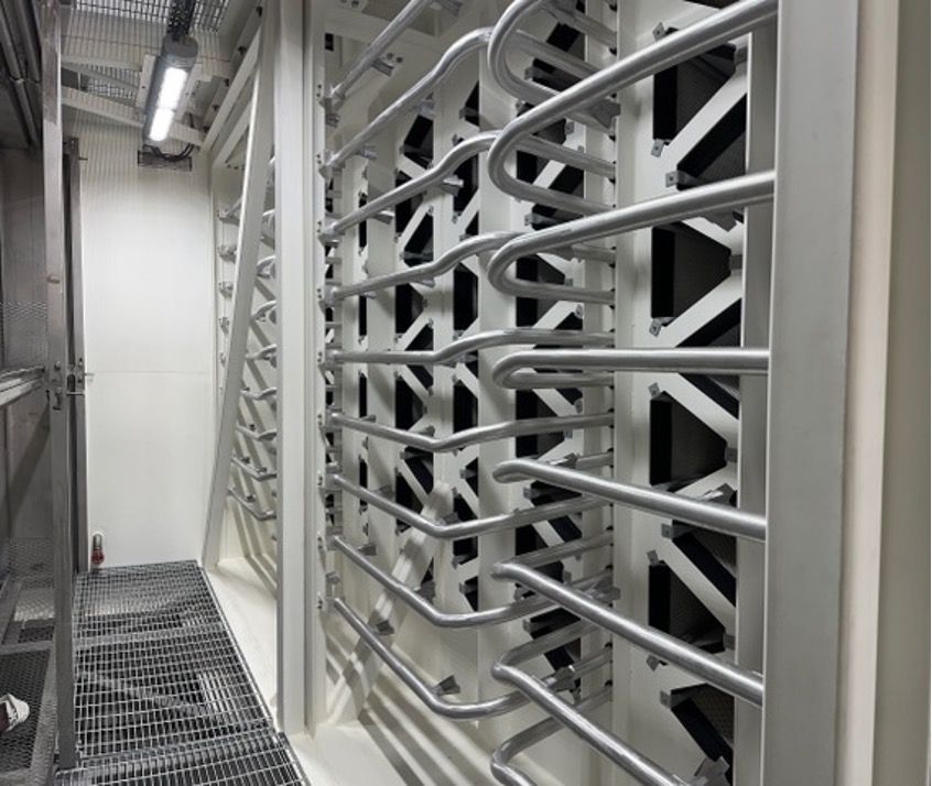

Improved pulse cleaning (Huff ‘n’ Puff) system and cycle for the new geometry filters.
An upgraded rotor and higher airflow would conventionally mean a bigger filter house, but this requirement is constrained by the available footprint at a brownfield site. Indeed, a larger filter house will not fit in the same footprint as an existing unit because an uprated system often has to be wider and taller. Many sites are critically restricted in width, especially if there is more than one gas turbine onsite with a fixed distance between them. In addition, height restrictions can also come into play due to power cables, fixed downstream ducting, or some other systems installed near the turbine. With space constraints affecting the available options, improving airflow performance is only possible by installing filters that run with a higher flow rate or fit within the same space.
Fortunately, while turbine technology has advanced to deliver improved performance, so have air inlet filtration systems. By using more modern and higher flow-rate technology, it is possible to have a filter house of similar dimensions to meet site constraints. Recent developments in filter elements can deliver appropriate airflow characteristics with no appreciable drop in air quality. The key development is that the filter geometry has changed, enabling a higher air flow rate for the same performance and improved nesting to optimize the space required for each filter. The changes in filter geometries—for example developing a generally triangular cartridge rather than a round one—were executed to reduce pressure loss and increase airflow throughput through the same space and reflect changing market demands.

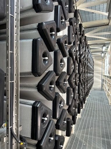

Optimized geometry pulse cartridge filters installed in the same filter house typology.
This is only part of a series of air inlet assemblies, such as weather hoods and coalescers, evaporative coolers, pulse cleaning, and anti-icing systems, that will be required to squeeze into the same footprint. With the correct technology in place, this is achievable, and it may be possible to use the same support structure that had served the existing filter house for additional CapEx savings.
