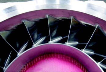

Figure 3: Modifications to the vane geometry would ensure the optimum inlet flow angle which would also improve the mass flow rate.
The data generated was compared to actual data from the compressor to refine the model with the correct working parameters. Once accuracy was confirmed, it was possible to introduce design improvements to the impellers, the labyrinth seals, the inter-coolers, the bearings and the shaft (Figure 2).
Each design change was simulated and evaluated. Modifications to vane geometry were aimed at achieving the optimum inlet flow and better mass flow rate (MFR) (Figure 3). A polymer material was proposed for use on the labyrinth seals to allow clearances to be reduced which would in turn reduce losses from the compressor.

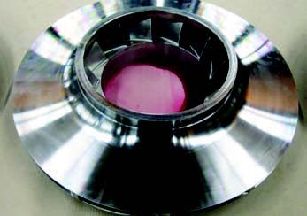

Figure 4: The new components were manufactured from a solid piece of chrome molybdenum vanadium steel using electrical discharge machining.

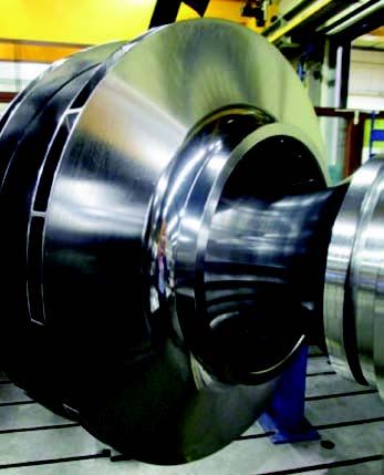

Whereas the original impeller was a welded design, the new components comprised a solid piece of chrome molybdenum vanadium steel (Figure 4). This was manufactured using electrical discharge machining (EDM) to provide a stronger, more durable component. Each impeller was spin tested before being mounted onto a new rotor shaft. In accordance with American Petroleum Institute (API) specifications, the spin test speed was carried out at 115% of maximum continuous speed.
The shaft was low-speed-balanced before each impeller stage was installed and then again once the assembly was complete. The operating speed of this rotor is over 8,800 rpm and the balancing was carried out at rated speed as well as at 10% overspeed. A process known as “trowalizing” refined the surface finish of all surfaces. It involves immersing the component in abrasive media, with a vibrating action being applied to the container. Gradually the component is polished by the media for a near-mirror finish.
The completed rotor assembly was delivered to the refinery ready for installation during the next scheduled maintenance period, along with the new inter-coolers.
