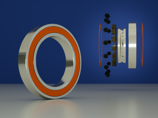

Silicon nitride (Si3N4) is one of the most promising materials in ceramic bearing applications. It is harder than steel, and its hardness is not affected significantly as the temperature increases. Performance can be enhanced further with hybrid bearings, which use ceramic balls and steel races, a combination that minimizes rolling friction and wear.

Silicon nitride (Si3N4) ceramic bearings are manufactured through a process called hot isostatic pressing (HIP), where a ceramic in powder form is subjected to high temperature and pressure in the presence of an inert gas, such as argon. Bearings manufactured with HIP have a minimal occurrence of surface defects and internal pores, increasing their resistance to fatigue and fracture.
Si3N4 has more wear resistance than steel. It has a hardness of 90 HRC (Rockwell C scale), while the hardest tool-grade steels are typically below 70 HRC. Si3N4 preserves hardness at high temperatures, while steel becomes more ductile and susceptible to deformation.
Si3N4 also has only one-third the density of steel. This enables the manufacture of lighter bearings and lower weight, as well as increased bearing stiffness. Unlike steel, Si3N4 does not conduct electricity. In applications where electrical isolation is required between the rotor and stator, ceramic bearings can perform a double function.
There are, of course, limitations. While its hardness raises wear resistance, Si3N4 is stiff and provides poor damping. This makes it unsuitable for applications where the rotor is subject to impact loads. Its rigidity may mean that failure is less likely than with steel.
However, once failure occurs, it is rapid due to silicon nitride’s lack of tolerance to deformation. Steel also has a greater tolerance to surface defects, which are worn down as the bearing rolls. A surface defect in a ceramic bearing may lead to cracks and other issues. Finally, many current nondestructive test methods depend on magnetism and conductivity. They cannot be implemented in the presence of non-conducting ceramics.
