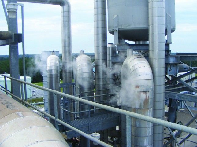

HRSG steam pipe leaks downstream of the attemperators.

Figure 1: Replacement of attemperator piping must be planned well in advance
Component redesigns
Factor in the sharp increase in plants conducting HRSG cycling, and many of these HRSGs can expect to need major component redesigns and replacements in the next ten years. That means combined cycle power plants will need more focus and coordination over the next few years than they did in the previous ten to identify and plan for the likelihood of HRSG capital projects.
There are several large HRSG projects that managers of combined cycle plants should assess thoroughly and include in any forecasts being done as part of GT and ST maintenance planning. Attemperator piping failure and replacement is a vital area to take into account (Figure 1).
Problems in this part of the HRSG are usually caused by a desuperheater overspray and short distance from a feedwater inlet to downstream elbow where liquid water is not able to completely vaporize before it comes into contact with a pipe and quenches it.
Desuperheater overspray is an operational issue and can occur when steam is sprayed to saturation or within 50°F of saturation temperature. But even well designed and properly operated desuperheater arrangements can experience a pipe failure.
All it takes is one leaky feedwater valve or faulty desuperheater probe. Some gas turbine upgrades from OEMs that allow lower loads and changes to the turbine exhaust conditions can aggravate this problem. Issues with attemperator piping are no small matter as redesigned piping systems can take 40 or more weeks to design and supply. Their assessment involves visual inspection of superheaters and reheaters for bowing, check of performance data to look for indicators of overspray, and quality non-destructive evaluation (NDE) of piping locations at risk to stress and cracking.

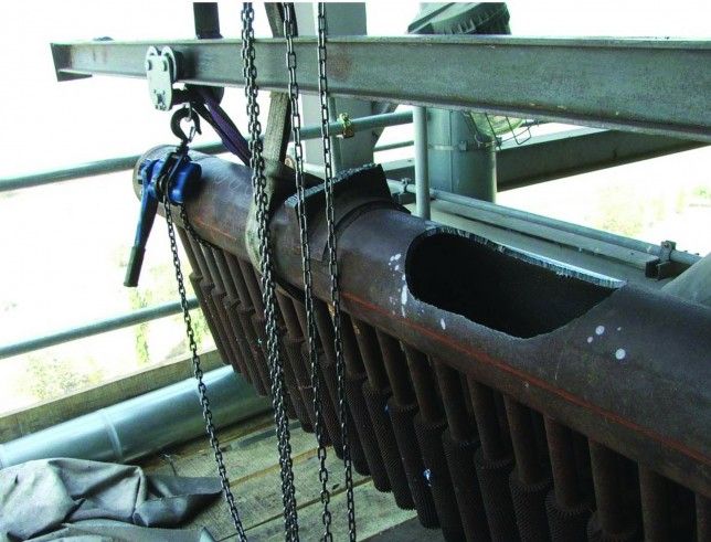

• Low Pressure (LP) Evaporator replacement or modification due to flow-accelerated corrosion (FAC) damage (Figure 3) or inside diameter (ID) pitting problems
• High Pressure (HP) steam drum weld cracking from multiple start-ups and shut downs

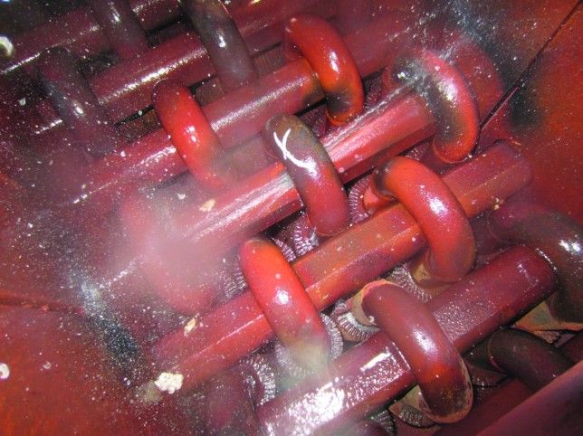

• Economizer replacements or modifications due to FAC damage, ID pitting or cycling driven failures (Figure 4). Similarly, accumulation of ID deposits in evaporators may require chemical cleaning and even replacement in the case of extensive tube damage.
Issues in these areas can be accelerated due to frequent on and off cycling of the gas turbine. This is becoming more common if power plants are to remain competitive on a grid with abundant renewable assets.
Microsoft Word - FINAL_Coordinated HRSG-GT Maintenance Planning

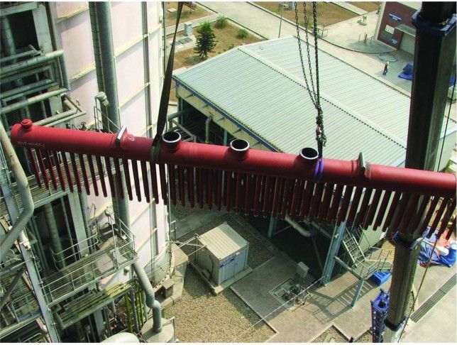

Figure 3: Removal of a low pressure evaporator header with flow-accelerated corrosion damage

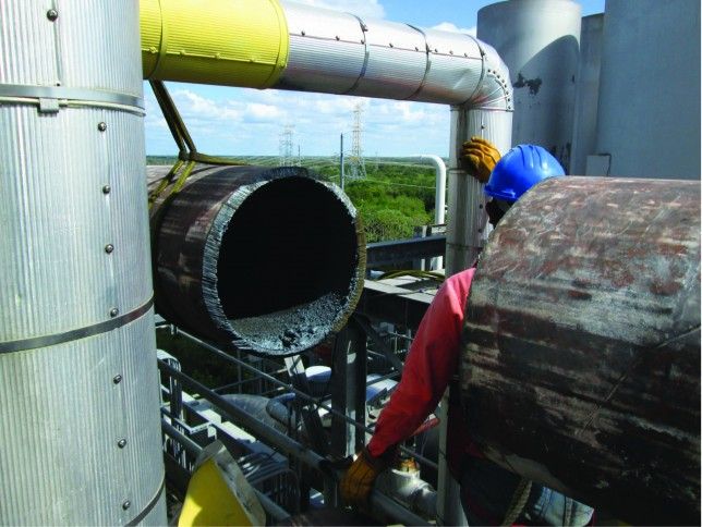

Economizers and LP evaporators become vulnerable to pitting and chemistry issues, further aggravated when they are offline and in wet-layup waiting for the opportunity to run. FAC, pitting and chemistry related issues are all internal and can be caught early with a borescope.

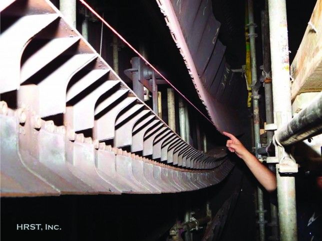

Therefore, periodic borescope inspections should be a part of a combined cycle maintenance program. Failure to keep a close eye on such matters could necessitate the installation of a new economizer (Figure 5).

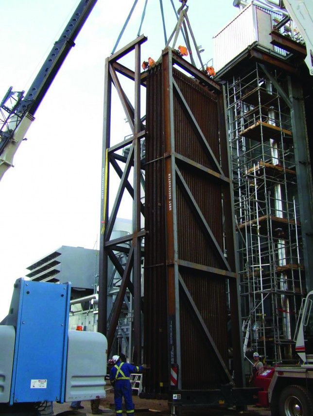

Figure 5: New economizer being installed at a combined cycle plant.

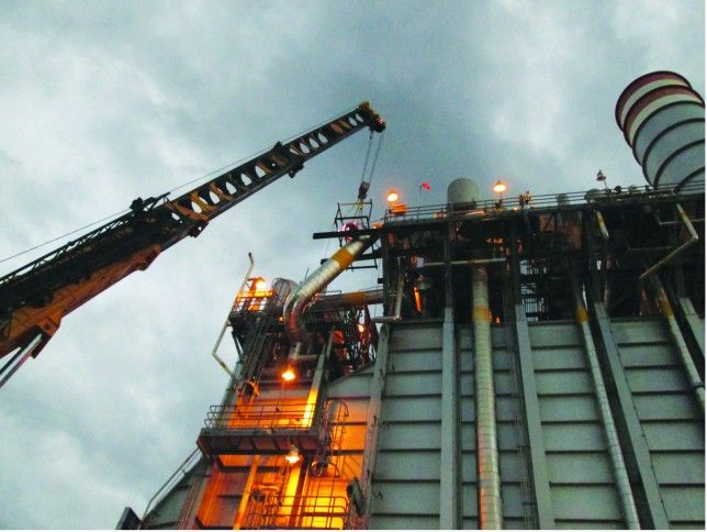

Maintenance managers would be wise to develop a multiyear planning forecast specific to their HRSGs. Such programs help to coordinate these large projects with GT outages, such as GT hot gas path inspections or major inspections that often last longer than a month.
Knowing what projects are due and the parts needed during upcoming outages helps with material sourcing well in advance (Figure 7). This will be found to be much cheaper than dealing with rush sourcing once the outage is upon you.

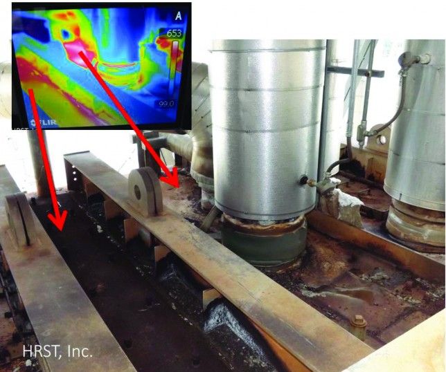

Figure 6: Overheating detected on the HSRG roof module
Inspect first
Good maintenance planning starts with a thorough HRSG inspection. Periodic inspections help to identify problems in the early stages and allow for general condition assessment, which in turn helps to plan and budget for more detailed inspection and future maintenance work.
It is advisable to conduct an HRSG inspection at least six months in advance of major GT or ST work. This is probably the last opportunity for a plant to identify serious issues and begin the process of ordering materials, scheduling contractors and equipment, and designing new or improved replacement components. Inspection findings may prompt additional work such as NDE, thermal imaging and lab testing.
