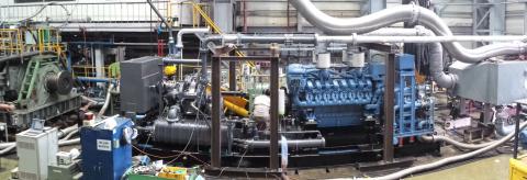

The proposed compressed air injection (CAI) scheme, commercially known as TurboPHASE is a modular package designed to increase plant power output, by restoring a portion of the missing inlet air flow caused by high ambient temperatures or plant location at high altitudes. Each module is designed to deliver between 10 and 12 lb/s (4.5-5.5 kg/s) of compressed air, which is roughly 1% of the airflow of an “F” class gas turbine.
An intercooled compressor capable to delivering such amount of air, at pressures above 250 psi (1.72 MPa) requires a power input in the order of 2 MW. A high efficiency reciprocating engine fueled by natural gas, or diesel fuel, is proposed to drive the compressor. This point marks significant differences with earlier compressed air injection (CAI) initiatives like those made by Nakhamkin et al. and others, who proposed an electric driven compressor.
As noted more than 2 MW of power is required to move each compressor. If 5% air injection is intended, more than 10 MW of the incremental power produced is required only to move the compressors. Electricity delivered to the grid, which is the ultimate goal behind power production is severely reduced. By using a reciprocating engine that uses the same fuel as the gas turbine to drive the compressors, the auxiliary electrical loads are reduced to a minimum, and all the incremental power can be sold to the grid.
