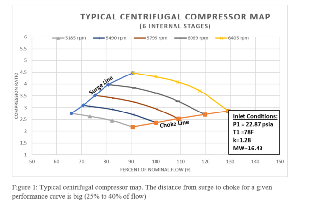

Axial compressors are used in large-scale processes where a significant amount of gas is required at a relatively low pressure. Typical applications are at the oil refinery’s fluid catalytic cracking unit (FCCU) as the main air blower, at the steel-mill as the blower for the blast furnace or as part of an industrial or aeroderivative gas turbine. Centrifugal compressors are more commonly used due to their versatility: they can compress a wide range of flows to a high discharge pressure. The stable operation of axial and centrifugal compressors is limited by surge and choke. Surge is a violent flow reversal that occurs when the process restricts the compressor flow below a certain minimum value.

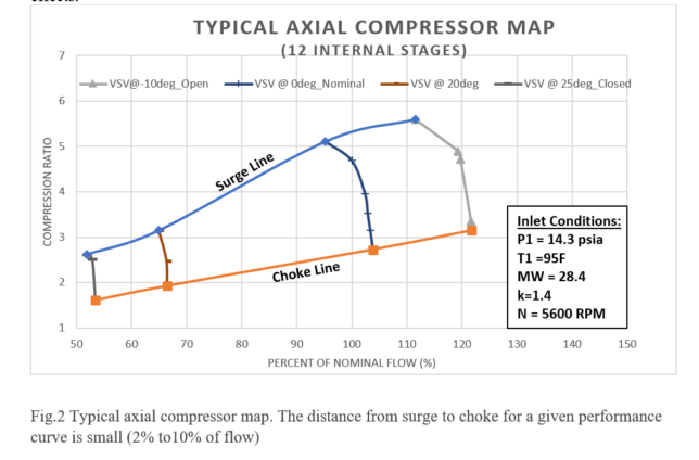

In axial compressors, however, this distance is significantly less (Figure 2). The more stages a compressor has, the higher the pressure ratio but the smaller the operational margin between surge and choke regions. Figure 2 shows the performance curves of a 12-stage axial compressor. The operational margin of a performance curve is significantly less than the one of a 6-stage centrifugal compressor shown in Figure 1.
OEMs are not always clear about the precise location of the choke line as most attention is given to the surge line. The same mistake is transferred to control systems, which focus exclusively on protection from surge. However, ignoring the effect of choke in axial compressors has cost refinery owners months of production loss due to the catastrophic failure of the axial main air blower (MAB), one the most critical pieces of machinery in the refinery. Compressor choke or stonewall is an unstable operating condition, which occurs when the compressor is operating at low discharge pressure and high f low rate. This leads to increased gas velocity in the compressor.

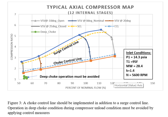

anti-surge valve is opened too much or for too long, and no back-pressure is created by the process. If the anti-surge valve is oversized, high travel limitation (clamp) must be established in the controller to make sure the compressor operating point enters the stable operating envelope as soon as it starts and remains there during operation in unload condition. It is vital to
avoid compressor operation in a deep choke condition from the beginning of
startup (Figure 3).

• Install an anti-choke valve immediately downstream of the anti-surge blowoff/recycle line and set up proper antichoke control, which must be independent from the anti-surge controller. Separate transmitters must be used as the distortion of a shared transmitter signal may have conflicting effects on the anti-surge and anti-choke controllers
• Make sure the process is always ready to provide enough back-pressure for
the compressor as soon as it is started. For example, place an initial set point of 10-15 psig at the FCCU regenerator. The slide valves should also be kept closed at the mechanical stop to help creating back-pressure. In the case of power recovery trains, the expander inlet and bypass valves can stay closed during startup of the train. If an anti-choke valve is present, start the compressor with that valve initially closed, then slowly ramp it open
• Perform a choke test in addition to a surge test to determine the choke line and establish a choke control line. Make sure the compressor can operate safely in the area close to the expected choke limit. A portable accelerometer can be used to determine if the axial blower is operating in a choke condition. In the author’s experience, radial vibration or axial displacement do not increase in a deep choke condition. An accelerometer placed in the casing

• Graphically illustrate in the HMI the exact location of the choke line, surge line and control lines. As choke is not noticeable (unlike surge), it is
vital that it be graphically shown on a real-time compressor
map
