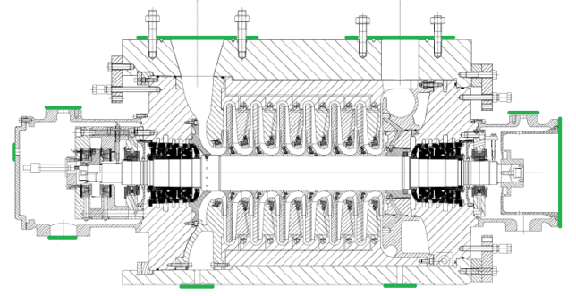

Figure 1: All connections must be be flanged (highlighted in green)

These actions should be done on site in this order. First, the compressor should be uncoupled from the driver. All connections must be flanged (Figure 1). As a further precaution, flanges should be taped around the circumference to ensure weather-tight sealing. Next, wash the compressor and pressurize it with nitrogen. The pressure must be maintained a little above atmospheric by means of a pressurization system (Figure 2).

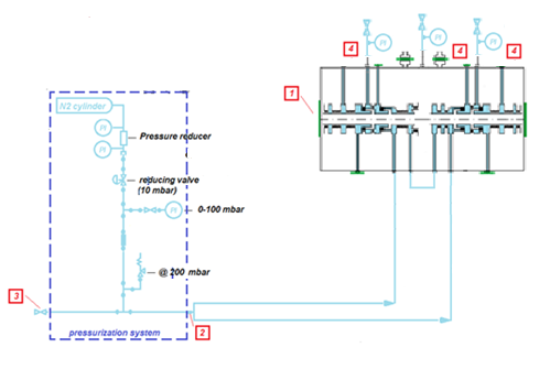

Figure 2: Pressure must be maintained a little above atmospheric pressure by means of a pressurization system as below picture (highlighted in light blue)
Before commencing compressor preservation, tests should be done on the pressurization system by plugging the line upstream to the seal connection (Figure 2, item 2) and closing the end valve (Figure 2, item 3). Open the nitrogen cylinder valve, gradually increase the pressure to its maximum setting (about 50-60 mbar), close the cylinder valve, wait about 30 minutes and record the pressure. After 24 hours, check and note the pressure. If there is no variation, the system can be depressurized, unplugged and made ready for the pressurized test of the compressor.
After connecting the system to the compressor, open the nitrogen cylinder valve, check that the pressure reducer in the cylinder is correctly set, and, if necessary, adjust it. Also verify that the pressure-reducing valve is properly set to close the nitrogen-cylinder valve.
Following a successful pressurization check, proceed with nitrogen purging using an external nitrogen source to eliminate humidity inside the compressor. This is accomplished by closing the nitrogen cylinder valve and using the connection upstream of the valve (Figure 2, item 3) to connect the external source of nitrogen.
Open the valves installed on the compressor’s self-buffering connection and vents ( Figure 2, item 4). Adjust the valve (Figure2, item 3) to achieve about 50-60 mbar of pressure. Wait for nitrogen purging, then close the valve (item 3). After that, close the valve on the self-buffering connection and vents (item 4) to maintain an internal pressure of around 15-20 mbar. Disconnect the external nitrogen source from the valve (item 3). After purging is complete, start the pressurization system by opening the nitrogen cylinder valve.
