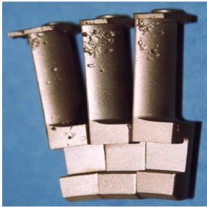

Severe steam turbine Rotor blade pitting[/caption]

Leaching is the removal of an element(s) in an alloy. The depletion of the leached element results in a base material chemistry change that can greatly reduce the material capabilities. High temperature corrosion products and scales are often found to have high concentrations of the leached element. Nickel and Chromium are two elements that commonly leach from the base materials and form oxide and sulfide corrosion products in highly alloyed gas turbine materials. Pitting corrosion is the local formation of corrosion by which pits, holes, cavities or crevices are produced in the surface of the base material. Pitting corrosion often occurs as the result of corrosive compounds laying on the part surfaces and creating a locally aggressive environment under the deposits.
Pitting corrosion can readily be a crack initiation point in Turbomachinery components and therefore considered to be more dangerous than general surface corrosion. Pitting corrosion is also more difficult to detect, predict and design against. A 40 percent reduction in fatigue strength/stress amplitude can occur from general surface corrosion without pitting, while more than an 80 percent reduction in stress amplitude can occur as the result of pitting corrosion.
