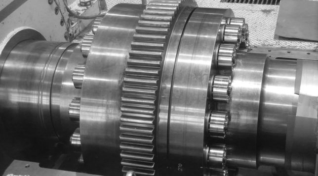

Caption: Superbolt EzFit assembled on a turbine generator coupling. This mechanical expansion bolt combines multi-jackbolt tensioners and an expansion bolt with controlled sleeve expansion

When fitted bolts seize in their bores, operators will try to remove them with breakout tongs, hammers and chillers. If unsuccessful, outage managers call for drilling and boring. But this generally damages flange bores and coupling faces.
An alternate approach is to use expansion bolts. As the bolt’s tapered body and the mating tapered bore sleeve are smaller than the hole itself, operators can install it perfectly by sliding it into the hole. Interference fits are unnecessary, with no need to freeze or heat the bolts. This eliminates radial clearance during the installation process and ensures uniform load distribution during operation.
Expansion bolts are positive locking bolting elements. Due to their increased rigidity, load amplitudes on the shaft line are reduced. Unlike traditional fitted bolts, the amount of radial force in the hole can be controlled.

Instead of a solid sleeve, mechanical expansion bolts use a split sleeve which is operated mechanically rather than with high-pressure hydraulics. The split sleeve mates with the machined coupling hole and requires less tolerance on mating parts than is traditionally required with interference fit bolts.
Since the sleeves are installed in clearance conditions and are expandable, the mechanical expansion bolt can accommodate slight hole size variations and hole misalignment.
They are suitable for couplings using bolts of 1-1⁄8" (28mm) diameter or bigger. This technology enables a controlled expansion of the split sleeve. This means that a precise radial force is imparted into the hole.
Designers can calculate the exact radial force needed for optimal expansion. This increases the reliability of the coupling and in turn, the application in which it is installed.
