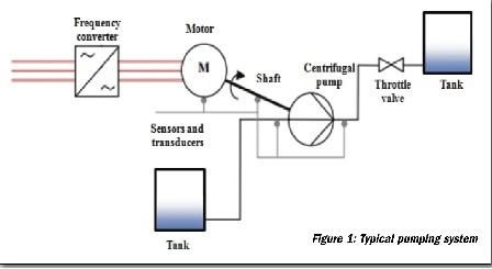

A typical pumping system consists of a driver, a centrifugal pump, valves and tanks. Advanced systems may include a VSD (Variable Speed Drive) block and sensors producing the variable feedback of the process (Figure 1).
