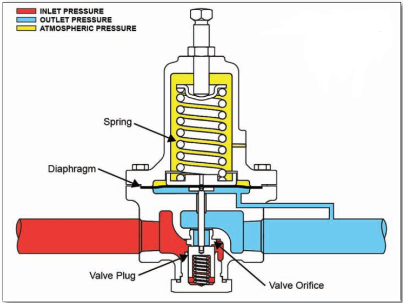

Standard, self-operated regulators are self-contained valve and actuator combinations that rely on three elements to control pressure downstream (pressure reducing) or upstream (backpressure) of the valve. These are a valve plug and seat to control flow, a diaphragm to measure system pressure, and a spring to load the diaphragm and provide a force balance to create a regulator set point (Figure 1).
Figure 1: The three essential elements of a pressure regulator
Figure 1: The three essential elements of a pressure regulator[/caption]

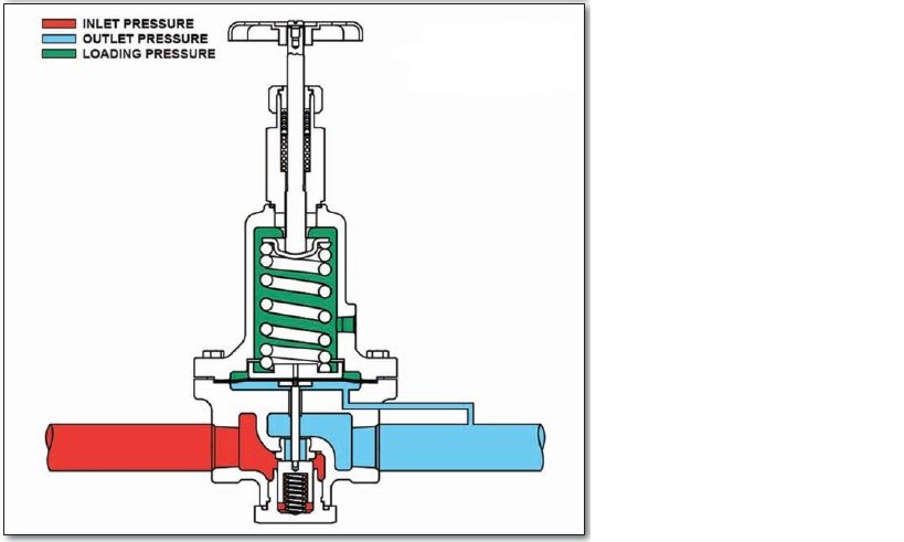

Differential control regulators operate in much the same way, but with an additional loading pressure added to the top of the diaphragm. This increases force and raises the set point of the unit (Figure 2).
Figure 2: Differential control regulator for both pressure reducing and backpressure service
Figure 2: Differential control regulator for both pressure reducing and backpressure service[/caption]

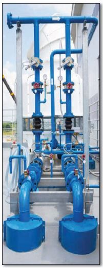

Figure 3: Seal oil skid with differential pressure regulators
Figure 3: Seal oil skid with differential pressure regulators[/caption]

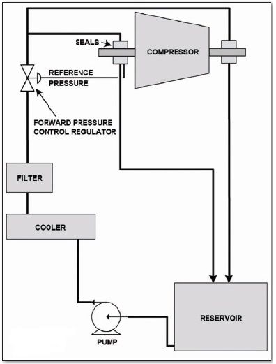

It is common to see differential pressure regulation in seal oil systems for centrifugal compressors and pumps (Figure 3). Pressurized oil in the seals keeps process fluid from leaking out of the machine via the shaft. This type of regulator is preferred as it is always sensing the reference pressure coming from the inner seal in order to make immediate flow corrections due to pressure changes in the reference fluid.
The regulator provides a supply of oil at a pressure slightly higher than that of the process fluid inside the machine. There are two main methods: forward and backpressure control. Both are accurate but forward pressure control method is more prevalent. It uses the pressure of the reference gas to increase the set point of the regulator (Figure 4).
Figure 4: Example forward pressure control system
Figure 4: Example forward pressure control system[/caption]
For backpressure control, on the other hand, the regulator is placed on the downstream side of the seals, sensing pressure upstream of the regulator coming from the seals. As pressure rises towards set point, the regulator begins to open and allow excess pressure to be relieved downstream, keeping the pressure through the seals constant.
