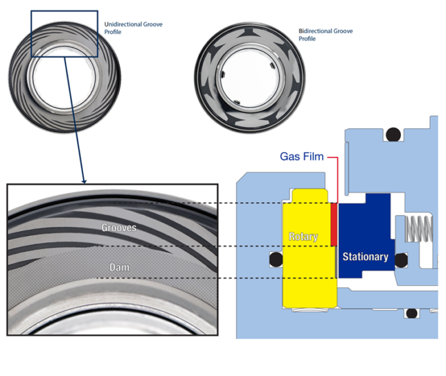

Figure 1: Generalized Dry Gas Seal (DGS) as used in process gas compressors

Gas seals have many functional similarities with their predecessors that include variants of face, bushing and floating ring seals. Yet, there are also features that differ. The seal face of the rotating mating ring can be divided into a grooved area at the high-pressure side and a dam-area at the low-pressure side.
The shallow grooves are often laser-etched, spark-eroded or chemically milled. A typical depth is ~0.0003 inch. T-shaped, V-shaped (bi-directional) and L-shaped (unidirectional) grooves have been produced; each configuration has its advantages and disadvantages. A stationary sliding ring is pressed axially against the mating ring by both spring forces and pressure exerted by the sealing gas.
The sealing gap is located between the mating ring and the sliding ring. For proper non-contacting operation these two rings must be separated by a gas film acting against the closing forces in the sealing gap. The gas film is achieved by the pumping action of the grooves and the throttling effect of the sealing dam. Groove geometry is critical for trouble-free operation of the seal.

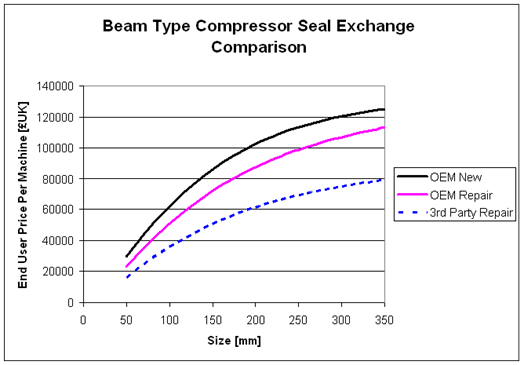

Figure 2: DGS repair cost versus nominal seal size (Courtesy of AESSEAL)

Consider dry gas seals that incorporate features ensuring start-up and acceleration to operating speed without allowing the two seal faces to make contact. Some manufacturers offer the option of repairing DGS systems from other OEMs (Figure 2). ■
