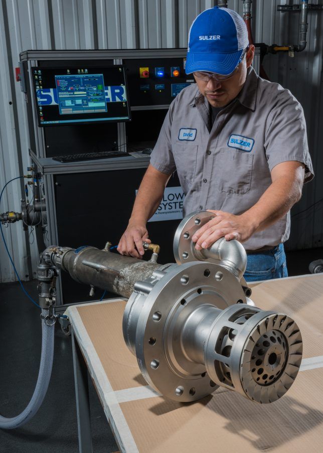

Figure 1: Flow test of 501 DF42 fuel nozzles with steam injection on high-flow test bench

Liquid flow testing monitors the flow rate of liquid-fuel and water-injection circuits of the fuel nozzles. Liquid flow testing also allows for the visual monitoring of spray patterns, which can indicate component wear or internal blockages. Liquid circuits need to maintain their spray patterns in order to achieve the correct flame profile and temperature distribution.
Wear or internal debris may cause combustor burnout. If this occurs, the flame can impinge upon the combustion liner or basket wall and cause component damage. Assessing liquid flows Fuel nozzle flow rates need to match those required by the manufacturer’s design specifications in order to achieve the expected output. These criteria may vary from one turbine to another, even if the turbines are of the same model type. An evaluation of flow data should be performed and made available for inventory spares or sets of fuel nozzles. Large operators minimize downtime during outages by using inventory spares. Spare fuel nozzles, for example, should be clearly identified with a reference that identifies the turbine they originated from and specific flow data.
