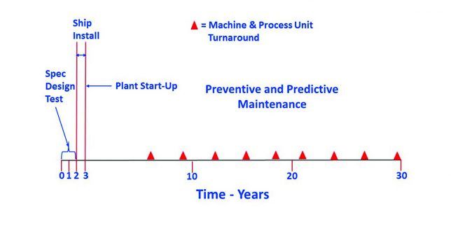

Figure 1: Machinery Life Cycle: A short time specifying, purchasing, designing and testing directly influences reliability, revenue, maintenance activities and turnarounds
Figure 1: Machinery Life Cycle: A short time specifying, purchasing, designing and testing directly influences reliability, revenue, maintenance activities and turnarounds[/caption]

Before, not after, begins with the cost effective critical machinery purchase or machinery rerate phase. The end user must be proactive in all phases of machinery purchase, design and condition monitoring to achieve optimum results. The purchase phase is the most important as it sets the foundation for the highest level of safety, reliability and revenue. Any omission of key reliability factors from plant, company or industry lessons learned influences the safety, reliability and revenue for the life of the process unit in which the machine is installed. It is vital to input all lessons learned and key reliability factors before finalizing the project budget estimate.
Based on experience, incorporating machinery best practices never increases machinery cost more than 10%. This preinvestment will raise plant and company revenue and profit over the life of the machinery (Figure 1).
