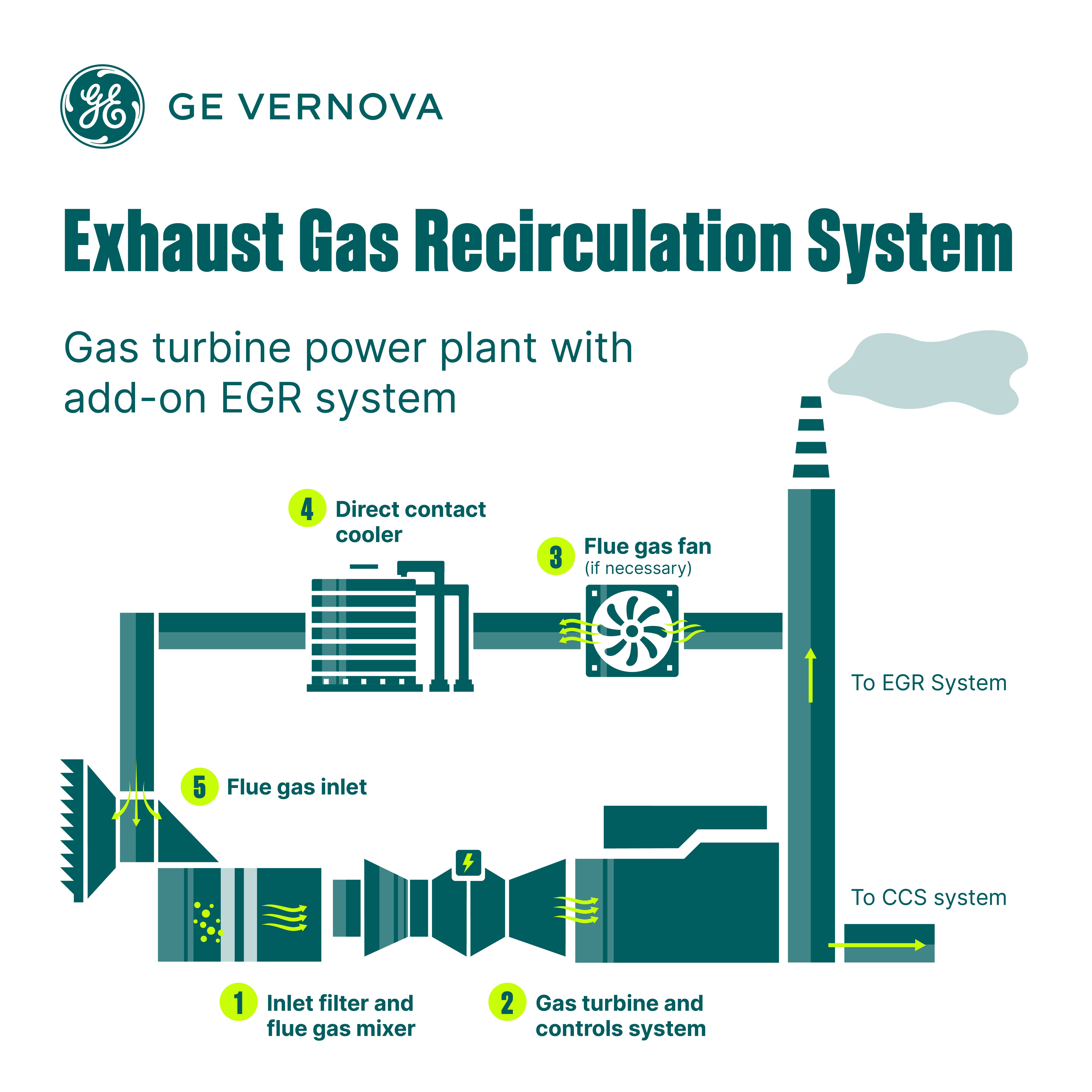

GE Vernova’s front-end engineering design (FEED) study, Retrofittable Advanced Combined-Cycle Integration for Flexible Decarbonized Generation, found the effects of adding a carbon-capture system to a natural gas combined-cycle (NGCC) power plant could be reduced through a series of integration measures, including an exhaust gas recirculation (EGR) system. The study findings—which was led by GE Vernova and completed in collaboration with Southern Company, Linde, BASF, and Kiewit—were released by the U.S. Department of Energy’s (DOE) Office of Fossil Energy and Carbon Management.
The study evaluated retrofitting the James M. Barry Electric Generating Plant in Bucks, Alabama, with carbon-capture technology. Integrating GE Vernova’s EGR system
could reduce more than 6% of the total cost of the carbon-capture facility compared to carbon capture without the EGR system.

  • employing GE Vernova’s EGR system, which reintroduces part of the exhaust gas back into the gas turbine inlet
The study’s approach reduced the size and costs of the carbon-capture system by cutting the number of absorber towers in half, improving the efficiency and flexibility of the plant, and potentially increasing its power output.
Compared to a non-EGR system, the potential of an EGR system offers a:
  • Large reduction of carbon-capture facility footprint and cost of absorber
  • Lower operating costs due to reduced amine degradation
  • Less energy-intensive separation due to higher concentration of CO2 in flue gas directed to the carbon-capture system
  • More steam turbine power output because of lower steam consumption
