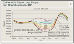

Most of us are familiar with the “Duck” and the need to manage its impact on the grid. As we make progress toward the Renewable Portfolio Standard (RPS), the duck’s “beer belly” will continue to grow.

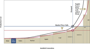

That impact on the “utility in residence” is to reduce its plant load factor, depress the market price for the power the plant produces, and propogate the renewable’s intermittency to the utility downstream assets. The “utility in residence” must then compensate for that intermittency utilizing conventional generating assets, most of which will be operating off their best efficiency point.
These conventional generating assets are forced to operate at a less efficient “off-design” condition and incur more frequent start/stop cycles that affect equipment repair and life cycle costs.

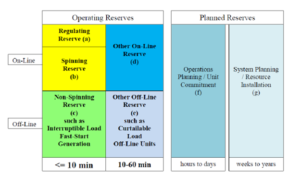

The DOE proposed, and as of now abandoned, NOPR recognized and attempted to redefine reserve assets as either On-Line and Off-Line. On-Line capacity is clearly more valuable than Off-Line. This embedded mindset is what has driven conventional utilities and their assets toward a fast start/stop capability.

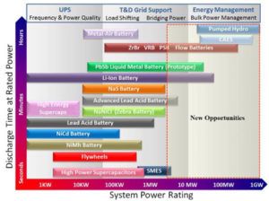

The following graphic has been in the literature since early 2000’s, but still seems relevant. The GE Gas Turbine/Battery Hybrid seems to fit nicely as a UPS system, and it is also now dispatchable in support of renewables integration, as well as a being able to serve a variety of anciliary services.
The LM6000 can include a fast start capability and when coupled with a battery, can served as a fast
response UPS system and/or an extended bulk power asset. The recent emergence of fast start gas
turbines is a critical success factor enabling this asset combination.
