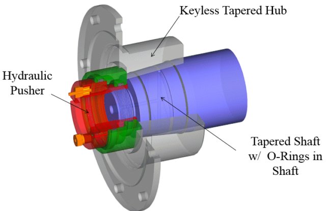

Caption: Hub with shaft end hydraulics.
The number of methods used to hydraulically mount tapered bore hubs onto tapered shafts is as numerous as the equipment manufacturers in the industry. Each Original Equipment Manufacturer (OEM) has its own design philosophy regarding the placement of O-rings, type of hydraulic fittings, and even the installation equipment to be used.
This article should not override methods defined by the OEM. It is intended to provide guidelines to help achieve the precise fit required between the shaft and hub and prevent equipment damage if proper procedures are not followed.
A common area of damage associated with hydraulic hub installation is scoring of the shaft or hub on the leading or trailing edges of the mating components.

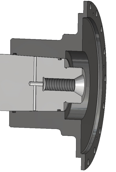

Configurations can vary due to the location of O-rings on the hub and shaft and the means used to introduce dilation pressure, which is used to expand the hub. A typical O-ring arrangement can be one O-ring groove on the shaft and the second on the hub.
Alternatively, both O-rings can be located in the hub, and occasionally, no O-rings are used. The dilation pressure can be introduced through the shaft end or through a radial passage through the hub.

Caption: The use of a hydraulic pusher is preferred to a lead hammer

More than likely, O-ring interference will prevent the hub from reaching its Zero Start Position. One accepted method of moving the hub up the taper is to use a lead hammer. Several blows of the hammer will seat the rings and allow the hub to move to the Zero Start Position. A more accurate way it to use the pusher tool to advance the hub to the Zero Start Position.
The pusher tool is designed to match the shaft end threads as it is required to be threaded onto the shaft at this location. The pusher tool is a hydraulic cylinder that will stroke enough to accommodate pushing the hub up the shaft the full pull-up distance. Once it is threaded onto the shaft end, it can be used to apply pressure to the hub, re-establishing the Zero Start Position.
An installation kit comprised of two hydraulic pumps is required. The two hydraulic pumps are manually operated, providing independent sources of both high pressure 35,000 PSI (241,320kPa) and low pressure 10,000 PSI (68,950kPa).
The low-pressure pump connects to the pusher tool and the high-pressure pump connects to the dilatation port (either in the shaft end or through a radial passage through the hub). Note that equipment damage and personal injury can result from mixing up the connections.
Before beginning the actual installation of the hub on to the shaft, recheck the Zero Start Position one last time. To begin installation, use the high-pressure pump and slowly increase pressure to about 12,000 PSI (82,740kPa) to begin dilating the hub. To prevent the hub from moving down the shaft as the dilation pressure builds up, use the low-pressure pump to develop sufficient force in the pusher tool to maintain the hub at its Zero Starting Position.
