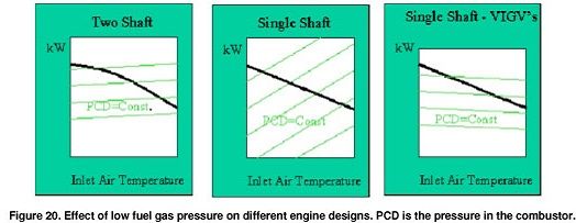

The above is valid irrespective whether the engine is a two-shaft or single-shaft engine. The fuel gas pressure at skid edge has to be high enough to overcome all pressure losses in the fuel system and the combustor pressure, which is roughly equal to the compressor discharge pressure p2. The compressor discharge pressure at full load changes with the ambient temperature, and therefore, a fuel gas pressure that is too low for the engine to reach full load at low ambient temperature may be sufficient if the ambient temperature increases. If the fuel supply pressure is not sufficient, single and two-shaft engines show distinctly different behavior, namely: A two-shaft engine will run slower, such that the pressure in the combustor can be overcome by the fuel pressure.
If the driven equipment is a gas compressor (and the process gas can be used as fuel gas), 'bootstrapping' is often possible: The fuel gas is supplied from the gas compressor discharge side. If the initial fuel pressure is sufficient to start the engine and to operate the gas compressor, the gas compressor will increase the fuel gas pressure. Thus the engine can produce more power which in turn will allow the gas compressor to increase the fuel pressure even more, until the fuel gas pressure necessary for full load is available.
A single-shaft engine, which has to run at constant speed, will experience a severe reduction in possible firing temperature and significant loss in power output, unless it uses VIGVs. With VIGVs, the compressor exit pressure, and thus the combustor pressure can also be influenced by the position of the VIGVs, thus leading to less power loss (Figure 20). Without VIGVs, the only way to reduce PCD pressure is by moving the operating point of the compressor on its map. This can be done by reducing the back pressure from the turbine, which requires a reduction in volume flow. Since the speed is fixed, only a reduction in firing temperature -which reduces the volume flow through the gas generator if everything else remains unchanged- can achieve this. A reduced volume flow will reduce the pressure drop required for the gas generator turbine.
