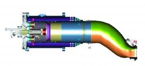

Figure 1: PSM’s LEC-III Combustion System cross section. To date, the PSM fleet of these low emission systems has surpassed 1.5 million hours and over 18,000 starts in more than 70 units. They can achieve sub-4 ppm NOx emissions over a pre-mix operating range with low CO, combustion dynamics and turndown from base load operation
Figure 1: PSM’s LEC-III Combustion System cross section. To date, the PSM fleet of these low emission systems has surpassed 1.5 million hours and over 18,000 starts in more than 70 units. They can achieve sub-4 ppm NOx emissions over a pre-mix operating range with low CO, combustion dynamics and turndown from base load operation[/caption]

PSM’s LEC-III technology was first incorporated into GE Frame 7E gas turbines in 1998. This can‐annular, reverse-flow combustion system (Figure 1) was designed to be a direct replacement into an existing GT outfitted with the OEM DLN1 system. The hardware scope of supply included combustion liners, end covers, primary fuel nozzle assemblies, secondary fuel nozzles (SFN), flow sleeves, transition pieces and bullhorn brackets, cross fire tubes, clips and spool pieces, combustion stub cases, combustion dynamics monitoring system (CDMS) and an NERC-compliant monitoring & diagnostic server. In addition, the project entailed a new gas-fuel skid (including piping and manifolds), combustion ignition and flame detection system, and flame scanners (redundant primary flame zone and secondary flame zone).
