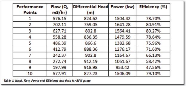

Table1: Head, Flow, Power and Efficency test data for BFW pump
Table1: Head, Flow, Power and Efficency test data for BFW pump[/caption]

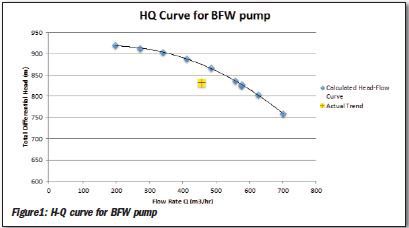

Figure1:H-Q curve for BFW pump
Figure1:H-Q curve for BFW pump[/caption]
The first step is to develop an Excel sheet with all relevant performance data (Table 1). The next step is to generate the appropriate graphs to monitor pump performance (Figure 1, 2 and 3). Once done, use the plant monitoring system (in this case PI Process Book) to capture and develop all process tags available in the database for the BFW pump.

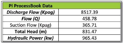

It is important to capture tags relevant to a particular piece of equipment. In this case, X,Y vibration readings, suction, discharge pressure, flow, bearing temperature and speed. Note that many of the tags used in such software can be easily called into Microsoft Office in real time for a detailed data analysis. Flow, suction pressure, discharge pressure, calculated total dynamic head (TDH) and hydraulic power for the pump were imported into Excel for analysis and monitoring (Table 2).

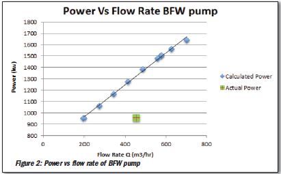

Once accomplished, the next stage is to integrate Excel data with process data to analyze, monitor and take corrective action when necessary. Figures 1 and 2 show the HQ and power curves, respectively, which incorporate the pump TDH flow and pump hydraulic power.
This helps present pump operation relative to its actual operation during a performance test after manufacturing. It shows how far the pump has moved away from the operating point, as well as estimates of operating power losses.
PI ProcessBook Data

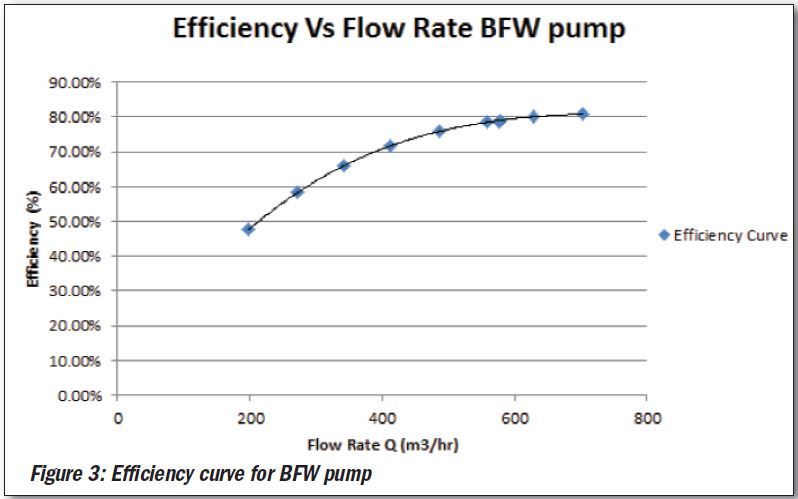

Figure 3: Efficiency Curve for BFW pump
Figure 3: Efficiency Curve for BFW pump[/caption]
Process and calculated data for BFW pump
Power vs Flow Rate BFW pump
Power vs flow rate of BFW pump[/caption]
Efficiency of a centrifugal pump is defined as the ratio of power out to power in. Pumps operating away from their best efficiency point (BEP) are not being used correctly. The causes are:
  • Internal wear of mechanical components leading to recirculation
  • Issues with pump bearings leading to high preload or over-lubrication
  • Running pumps with throttled discharge valves
  • In-correct pump selection for the application.
