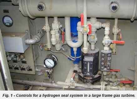

Hydrogen is the medium of choice for cooling about 70 percent of electric power generators over 60MW. It is more efficient for dissipating the heat load in generators compared to water, air or oil. Most large frame gas turbine models use hydrogen as cooling medium for their generators. Oil, often the same turbine oil used for bearing lubrication, is used as an occlusive seal to keep the small molecules of hydrogen gas from leaking down the shaft and out of the generator.
Seal oils face extreme conditions, and upon degradation may cause significant problems to seal systems leading to mechanical failure of the seals, loss of coolant, and possible safety concerns.

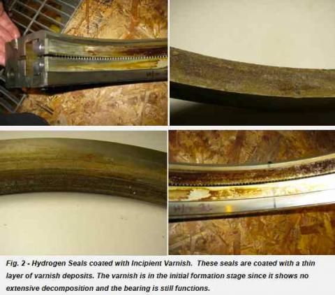

Hydrogen seal deposits range in severity. Below are several examples of problematic hydrogen seals. Hydrogen seal varnish can be classified as:
1. Incipient varnish – beginning of varnish formation
2. Propagating varnish – spreading widely of the varnish
3. Critical varnish – varnish is in danger of equipment reliability
Incipient varnish
Incipient varnish is a thin layer of deposits that are usually yellow to light brown in color. Typical clearances in the hydrogen seals is between 0.07”-0.12”. Even though these deposits appear to be a very thin layer, the depth of the varnish is sufficient to impact the dynamic clearances in the seals. Deposits may not be uniform around the entire seal surface, leading to areas of higher and lower flow and exacerbating problems.

The operation of the seal is where oil is pressurized in-between two seals (C/E= Collector End toward the generator and T/E = Turbine End toward the turbine). The oil is drawn into the seal by the spinning action of the rotor shaft with the aid of this oil pressure. This action pulls oil into the seals and out toward each shaft end to prevent hydrogen from migrating through the seal.
