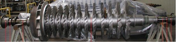

Large capacity main axial compressor rotor[/caption]
