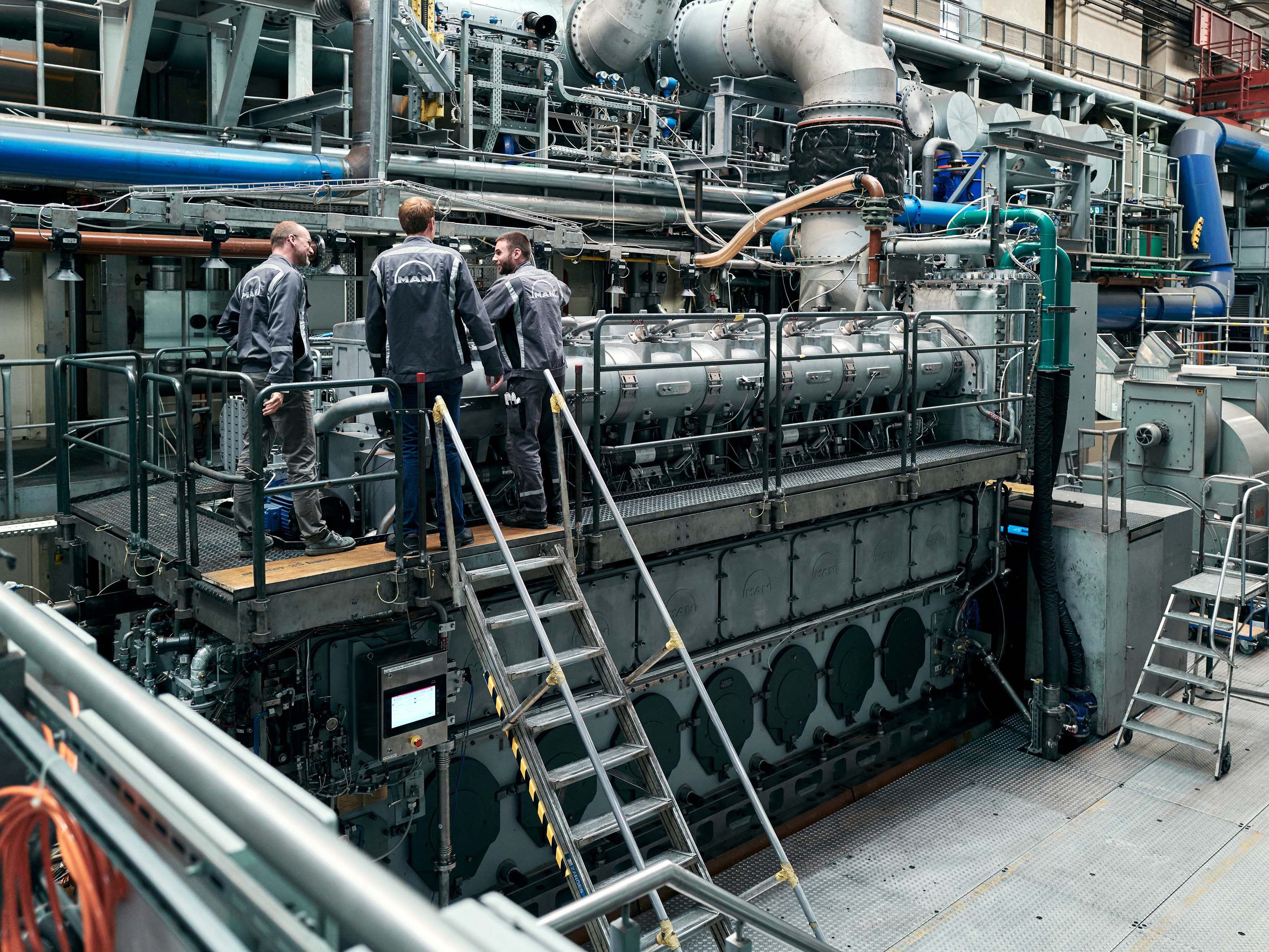

Starting in 2025, MAN PrimeServ will offer a retrofit package to convert deployed MAN four-stroke engines to dual-fuel methanol operation. Customers will convert their MAN 48/60 engines to the latest 51/60R-DF-M engine type with methanol capability, with or without a common-rail system. In addition to dual-fuel methanol operation, customers will benefit from higher engine efficiency during diesel operation. The engines will be equipped with MAN Energy’s control and safety systems.
“Climate-neutral shipping can only be achieved with synthetic fuels, and green methanol is particularly suitable for four-stroke applications due to its favorable energy-density,” said Stefan Eefting, Head of MAN PrimeServ Germany. “In this context, we have already received many retrofit enquiries from customers who want to switch to methanol. With our new methanol-retrofit package, we can now offer customers an economically attractive opportunity to convert older engines to a future-proof type.”
According to MAN Energy Solutions, the conversion package has been under development and tested at its Augsburg plant since summer 2024. MAN PrimeServ will perform the first four-stroke engine retrofits for a pilot customer in fall 2025, with the package coming to market shortly after.
“We have already gained extensive experience in methanol operation with the MAN 51/60R-DF-M in a series of tests,” said Alexander Knafl, Head of Engineering R&D Four-Stroke at MAN Energy Solutions. “We have achieved pleasing results in both combustion management and methanol injection and are now focusing on further optimization. Our aim is to ensure a consistently high engine-efficiency, regardless of the fuel type—diesel or methanol.”
