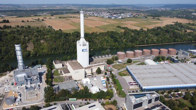

Ansaldo Energia announced the commercial operation of Marbach power plant, its second project within the German TSO strategic grid reserve initiative. Marbach is a 300-MW simple-cycle thermoelectric plant equipped with Ansaldo’s AE94.3A gas turbine and generator. This equipment combination can generate electricity for over 200,000 homes, boosting Germany’s energy security.
The Marbach plant can operate in gas-shortage situations by using oil and eventually green, decarbonized liquid fuels such as hydrogenated vegetable oil with NOx emissions below 50 mg/Nm3. Ansaldo’s AE94.3A gas turbine delivers high flexibility for the plant, with a ramp rate of 50 MW/min and reaching full load in 26 minutes. It is currently installed in more than 110 units with more than five million equivalent operating hours. The company’s gas turbine fleet is capable of mix-combustion with hydrogen, with the AE94.3A turbine reaching 40% mix.
