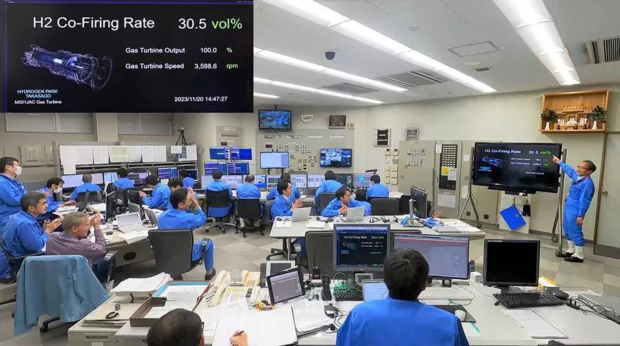

Mitsubishi Power conducted a successful power generation test using a 30% hydrogen-natural gas blend at partial and full load in a 1,650ºC J-series air-cooled (JAC) gas turbine. The demonstration took place at the T-Point 2 combined-cycle power plant validation facility within Takasago Hydrogen Park (THP). Fueled with hydrogen produced at THP, the large-frame gas turbine was connected to the local power grid and operated with a 30% hydrogen fuel mix to assess the technology’s potential integration at scale.
The test demonstrated low NOx emissions, stable combustion during hydrogen co-firing, and the ability to switch from natural gas to hydrogen fuel blending during partial-load and full-load operation. In 2024, Mitsubishi Power will perform a 100% hydrogen-firing test with a small to mid-size 40 MW H-25 gas turbine that had been installed to drive compressor operation at the park’s test facility. In addition to a 100% hydrogen test, the company plans to expand the hydrogen storage facility and conduct a demonstration using a 50% hydrogen blend.
