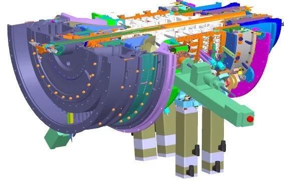

Simultaneously, a dual-shaft compressor rig is in the works at MTU in Munich to augment the compressor system. The rig also includes the inter-compressor duct (ICD).
"Our goal is to create even better coordination between the low-pressure compressor, ICD, and high-pressure compressor in order to leverage new potential for even more fuel-efficient engines," Riegler said. A crucial aspect is the systematic measurement of flow conditions in short, steep ICDs.
Testing of the dual-shaft rig is expected to begin at the DLR in autumn, with completion and evaluation set for next year. These validated technologies will contribute to future geared turbofan engines. GKN Aerospace is collaborating with MTU, with the Swedish engine specialists responsible for the design and manufacturing of the low-pressure compressor and the transition duct.
