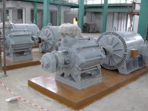

Condensate pumps by Sigma Group in Mochovce nuclear plant in Slovakia[/caption]
Condensate pumps are only required for condensing type steam turbines in which steam exits the steam turbine at vacuum condition and condenses into water in the surface condenser. Condensate pumps are used to circulate the condensed steam (condensate) back to the deaerator tank. For large condensing steam turbine systems, condensate pumps are usually overhung centrifugal type. Although those condensate pumps might not necessarily comply with API 610 requirements, they should be ISO compliant. The condensate pumps are usually designed in 2x 100% configuration in which one pump is operating while the other one is on stand-by mode to ensure the required level of availability of the steam turbine system. Condensate pumps are designed to operate at a fixed flow rate. It is recommended to have the rated flow condition for the pumps at 120% of the normal operating flow to cater for off case conditions.
