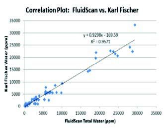

on site oil figure 1
Figure 1: FluidScan Handheld IR Analyzer water results compared to traditional Karl Fisher laboratory method

Water is the most common liquid contaminant in power plants, and should always be monitored. Excessive water destroys a lubricant’s ability to separate opposing moving parts, allowing severe wear to occur. For most equipment water contamination should not exceed 0.25%, and not more than 100 ppm for turbine lube and control systems. A number of new technologies are available to detect water contamination in lube oils, and on-site results correlate with laboratory techniques (Figure1).
