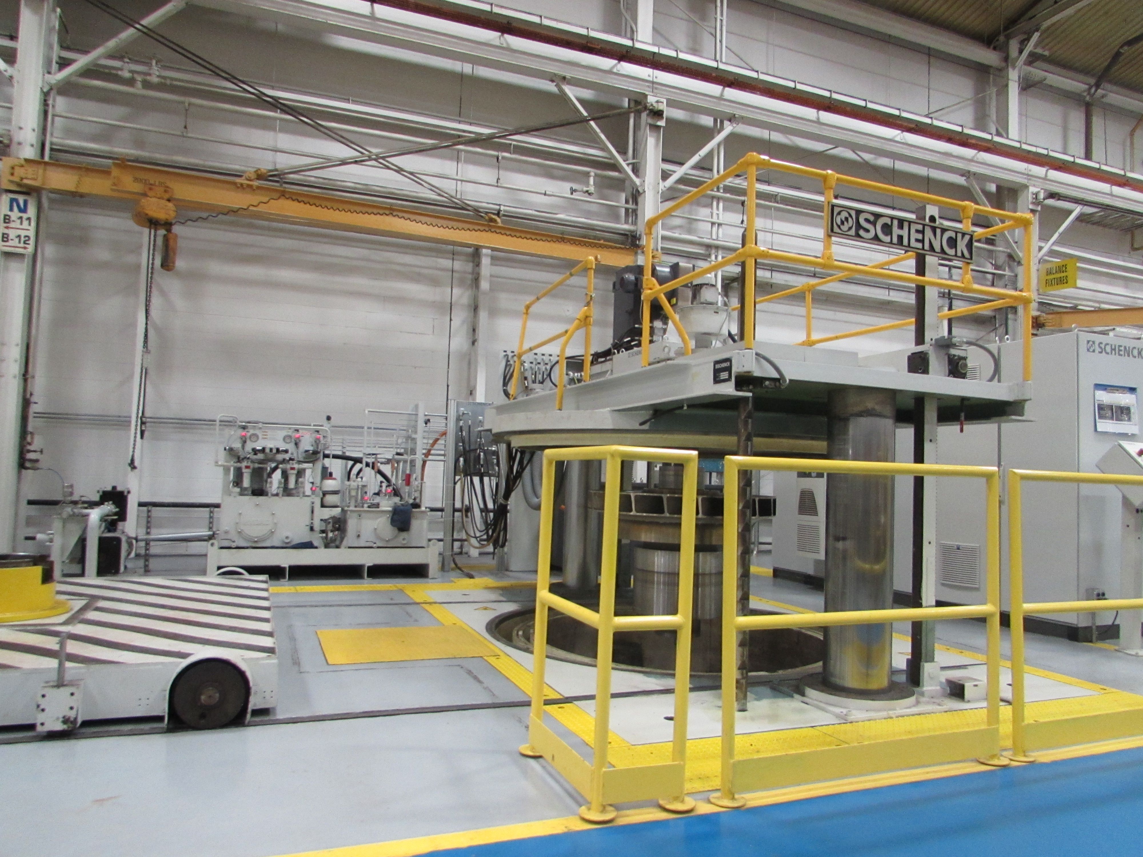

The overspeed test pit. The mandrel assembly is positioned on the cart (far left), which is rolled under the overspeed machine where it is fastened to the spindle. It is lowered into the pit, and a vacuum pump evacuates the chamber to minimize the power required to drive the impeller and heat generation associated with windage.[/caption]

The overspeed machine used for testing can be outfitted with various mandrels (fixtures or shafts that retain impellers when mounted on the spindle of an overspeed machine) to accommodate different sizes of impellers and speeds. The machine continually measures vacuum pressure, speed, and vibration during the test. The latter is measured with a proximity probe.
The unit is designed to trip and shut down when a maximum vibration of 8.0 mils is reached.  This is referred to as 100% full scale (FS) amplitude. The machine uses rolling element bearings with a squeeze film damper bearing in series. A key phaser was added to enable rotor dynamics analysis investigation. A 150 HP (112 KW) main drive motor is connected to the mandrel via a belt drive.
The shafting is oriented in a vertical direction, and a ‘bumper’ bearing is located on the bottom of the machine. The mandrel is manufactured so that a pin is located at the bottom of the mandrel. During mandrel installation, the pin fits inside the bumper bearing with a 0.020-inch (0.51 mm) clearance. This limits the motion of the mandrel and impeller in the event of excessive vibrational amplitude.

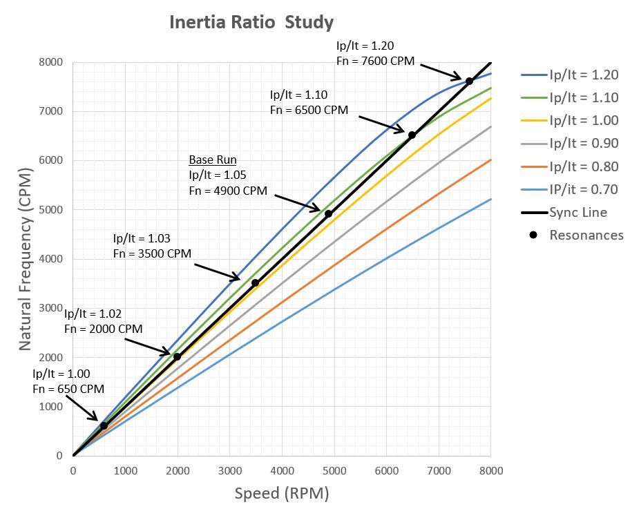

Further investigation looked into whether the vibration trip event was the result of an inertia dominant resonance condition, as the Ip/It inertia ratio was outside the recommended operating limits documented in the overspeed machine operator’s manual. In this case, the Ip/It inertia ratio was 1.05. It became evident that it was necessary to understand the phenomenon more clearly to determine the best way of addressing it.
Damped Eigenvalue Plot for mandrel assemblies showing curves for Ip/It inertia ratios ranging from 1.20 - 0.70. The resonance frequencies (intersections with the synchronous speed line) change rapidly as the inertia ratio is reduced from 1.10 to 1.0, so this region should be avoided. For inertia ratios below 1.0, the resonance frequency is in the 100 cycles per minute (CPM) to 300 CPM range.[/caption]
Theoretical basis
An inertia study was performed. The separation distance between the disks was varied to change the transverse inertia and associated Ip/It ratio. It is evident that the natural frequency for inertia ratios close to 1.0 is sensitive to small variations in modeling, boundary conditions, and assumptions.  For this reason, operation at inertia ratios between 1.0 - 0.95 should also be avoided.

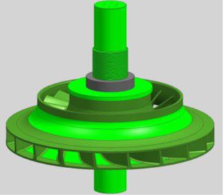

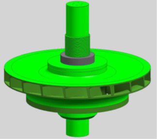

Flywheel testing ultimately proved to be unsuccessful due to problems associated with repeated vibration during start-up and shutdown. However, during testing, it was noted by shop personnel that, in some instances, impellers ran better when they were mounted with the shroud facing downward. As the newly designed mandrel was not yet available for testing, this suggestion was noted and tested. The flywheel was then removed, and the impeller mounted on the existing mandrel with the shroud facing downward.
Impeller shroud facing up (top) and impeller shroud facing down (bottom).[/caption]
With the impeller shroud facing down, the rotor assembly successfully reached overspeed. One factor that may account for this result is the Ip/It inertia ratio. It increased from 1.05 to 1.13 after flipping the impeller. Another factor is the residual unbalance. It may have shifted closer to the mandrel’s center of gravity. Rotor dynamic calculations indicate that if the unbalance shifts by a little as 1.0 inch (25.4 mm), such that it coincides with the mode’s pivot point, the system response is virtually eliminated.

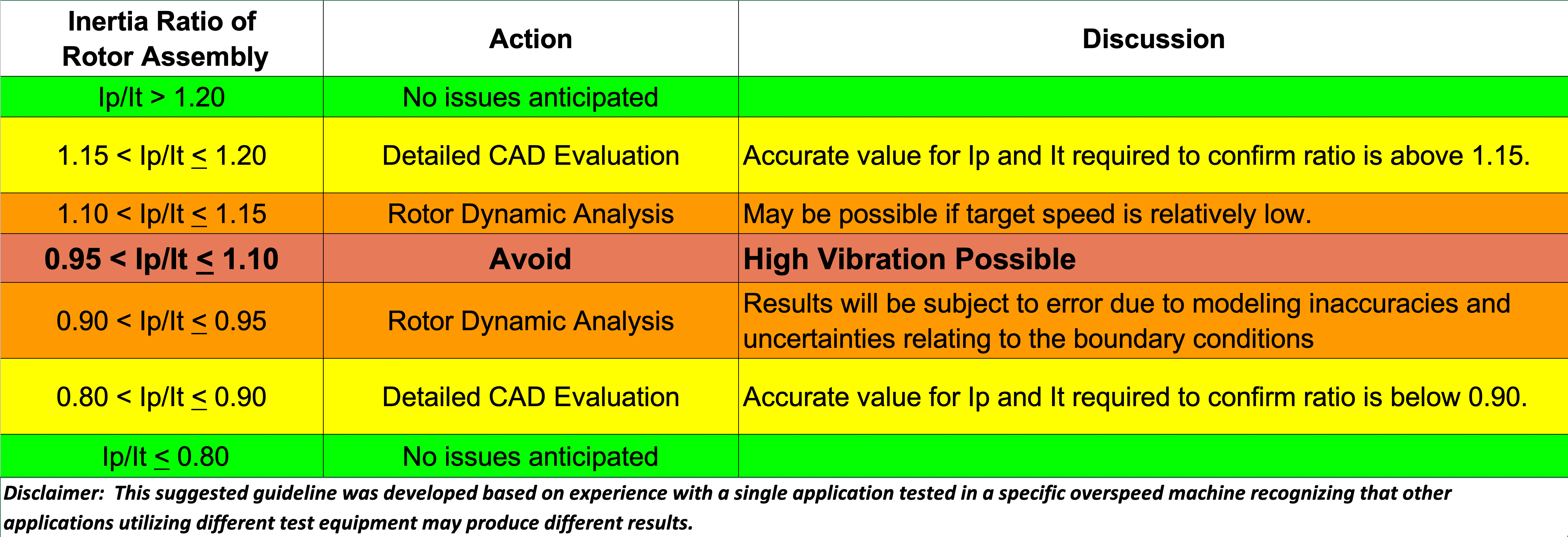

Insertia ratio guidelines.[/caption]

The probability for success when operating near the 0.95 < Ip/It <1.10 inertia ratio range improves if the following guidelines are observed:
  • Align the center of gravity of the impeller close to the pivot point of the rigid body mode. The pivot point is near the CG of the mandrel assembly. This will help to reduce system response. installing the impeller on the mandrel with the shroud facing down resulted in a successful overspeed run, albeit not conforming to the overspeed machine manufacturer’s Ip/It guidelines.
  • Confirm that the component fits are sufficient to remain engaged to maintain concentricity throughout the speed range.
Our analysis shows that the observance of these suggested guidelines promotes successful overspeed testing per API 617 standards.
