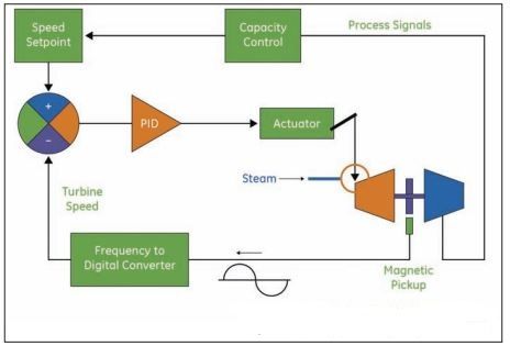

Figure 1: Integrated control system design for optimized safety, reliability and performance
Figure 1: Integrated control system design for optimized safety, reliability and performance[/caption]
The primary control system is the first line of defense against overspeed, typically referred to as Normal Overspeed (NOS) protection (Figure 1). It is an essential element in ensuring safety of the machinery . The primary controller regulates machine speed and load output by controlling the fuel delivery that powers it.
Furthermore, it regulates the amount of energy input to the rotating machinery that drives speed and load output for either electrical power generation or mechanical work performed through pumps, compressors and blowers. As increasing power output is required for higher loads on driven machinery such as generators or compressors, the risk of machine overspeed upon sudden loss of load increases proportionally.

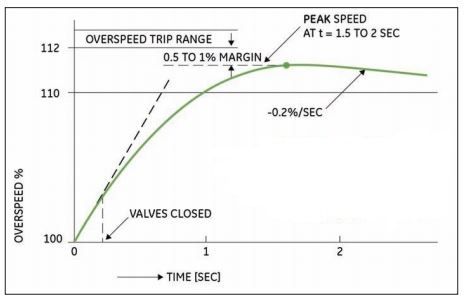

Figure 2: The dashed line represents turbine acceleration if Normal Overspeed protection doesn't work as designed. The solid line is the expected acceleration curve if Normal Overspeed protection works properly upon loss of full load
Figure 2: The dashed line represents turbine acceleration if Normal Overspeed protection doesn't work as designed. The solid line is the expected acceleration curve if Normal Overspeed protection works properly upon loss of full load[/caption]

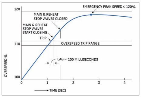

Theoretically, the NOS protection system should prevent any overspeed events. But, in reality the system can not always catch overspeed events before they happen (Figure 2). The Emergency Overspeed (EOS) protection system (Figure 3) is an extra layer of protection that operates independently from the primary control system. It acts as a second line of defense and has the independent ability to determine if the machinery is headed for catastrophic overspeed.
Figure 3: Diagram for emergency overspeed of a “slowly accelerating” unit on loss of full turbine load with the first line of defense not working properly
Figure 3: Diagram for emergency overspeed of a “slowly accelerating” unit on loss of full turbine load with the first line of defense not working properly[/caption]
EOS protection systems for older turbomachinery are typically mechanical emergency governors, more commonly known as mechanical bolts, installed directly on the main turbine shaft. More modern control systems incorporate various forms of electronic overspeed protection systems. These emergency systems are designed to respond when NOS protection systems fail to prevent the equipment from operating at rotational speeds exceeding about 110% allowed in maximum design.

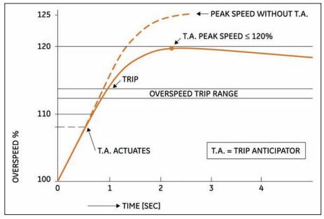

Although primary control and emergency overspeed protection systems must work independently, they also must be designed to work together effectively as a total protection system (Figure 4).
Figure 4: Diagram of emergency overspeed of a “fast accelerating” unit with trip anticipator function (typical) on loss of full turbine load with all controls working properly (solid line) and without trip anticipation (dashed line)
Figure 4: Diagram of emergency overspeed of a “fast accelerating” unit with trip anticipator function (typical) on loss of full turbine load with all controls working properly (solid line) and without trip anticipation (dashed line)[/caption]

A robust control system should anticipate trip conditions and control the safety valves without tripping the turbine in a rapid loss of load event. A well-designed primary control system should anticipate trip or loss of load events, giving itself valuable additional milliseconds to respond before an actual unit trip must take place.
It is important, then, to avoid unnecessary trip events through effective turbomachinery control without sacrificing robust machine protection. Once an a voidable trip event occurs, the cost of lost production can be high.

Also, an overspeed analysis is needed to account for element lag times in trip systems to determine the amount of entrained energy (the amount of high-pressure and temperature energy that has already passed your safety and control valves) that will continue to accelerate a machine after an emergency trip event is activated.
