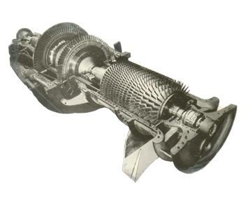

of a GE MS 3002 in a gas compression station in Algeria. It is fueled by natural gas transported by pipeline from line that passes close to a pumping station. Control instrumentation is installed at the station to track the status of the machines and adjust pressure, temperature, volume and density.
Thermodynamic analysis indicated possible improvements are based on performance control of a gas turbine (GT). This may offer improvements over traditional methods by boosting thermal efficiency the net mechanical power output, thus reducing specific mass through the inter-channel turbine blades. Modeling was done using the GE MS 5002b GT. This highlighted the fact that performance is influenced by the temperature of the ambient air which varies seasonally.

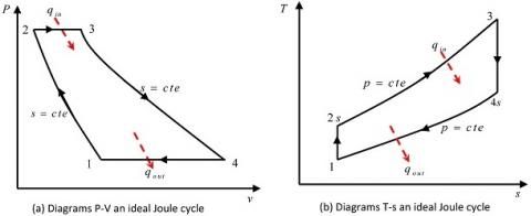

Figure 1: The thermodynamic cycle of a GT
Figure 1 shows the conventional temperature - entropy (Ts) diagram of a thermodynamic cycle). Air is compressed in the compressor between position 1 and 2. Heat added to the combustion chamber carry back the cycle from position 2 to 3. Hot gas expands and the Brayton or Joule cycle has two processes, an isentropic process (adiabatic and reversible) and an isobaric process. The main variables are minimum temperature T1, maximum temperature T3 and the pressure ratio, or compression ratio .
In ideal Joule cycle processes: compression (1, 2) and expansion (3, 4) reproduce in the compressor and the turbine respectively, and they are supposed to be isentropic; added heat (2, 3) in the exchanger heat (combustion chamber) and rejection (4.1) occur at constant pressure. Some hypotheses are considered during this cycle as follows: pressure losses in the heat exchangers and the passages connecting the equipment are negligible; and the operation fluid is a perfect gas; the efficiency of heat exchangers is 100%.

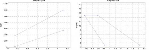

Testing at the SC2 compression station at M'SEKA, Algeria included the calculation of compensated thermocouple readings, selection of the reference point for temperature control, calculating of the value of the control point as well as temperature and exhaust values. These were then compared to reference values to generate a fuel control signal to limit exhaust temperature. Figures 2 and 3 illustrate the temperature evolution (entropy (Ts)-(Pv)).
Figure 2: Obtained diagram entropy (Ts) of Brayton Cycle
Figure 3: Obtained diagrams Pv an ideal Joule cycle

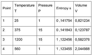

In an open Brayton cycle, air is aspirated in at the compressor at position 1 equivalent to (25°C) to position 2 with a pressure of 1 bar and compressed to 15 bar. Heat added in the combustion chamber carries the cycle from position 2 to 3, which exits at a temperature of (1200°C). Table 1 summarizes the modeling steps.
Table 1: Data Modeling
Note that as compressor inlet temperature increases, the specific compression work increases while the air mass flow rate decreases due to a decrease in specific gravity). Accordingly, there is a decrease in turbine efficiency, useful work and power. If the temperature decreases, the reverse happens. If atmospheric pressure decreases relative to the reference pressure, the mass flow rate decreases and useful power is reduced proportionally.
If relative humidity increases, power output decreases and specific consumption (RH) increases. From the obtained results, therefore, it can be confirmed that there are other factors affecting turbine performance defined as "inner" factors, as they are related to ancillary systems. Thermodynamic calculations show that performance is influenced by the temperature of the ambient air which varies considerably with the seasons. The ideal Brayton cycle presents an approximation of the thermal processes. This concept can be used as a base of control, and analysis of real cycles deviating from the ideal model.
