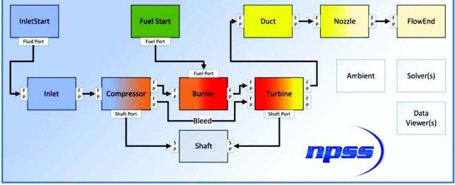

However, since it is fundamentally a flow-network solver, it has also been applied to a variety of other fluid and thermal subjects such as multi-phase heat transfer systems, refrigeration cycles, variations of common power cycles (i.e., Brayton), and overall vehicle emission analyses (Figure 1).
In a typical air-breathing engine block diagram the cycle is represented by the various thermodynamic processes, such as compression, combustion and turbine power extraction. When developing a model in the NPSS environment, the engineer specifies the type and order of the necessary components, referred to as “elements,” and provides the technical data that describe their individual performance. NPSS comes with a library of thermodynamic property databases and standard elements for use in engine cycle models.
Using such a tool, the operating company can develop a model of their particular gas turbine units using information they know from machine performance data and visual and physical inspection. They can tune their models to match the design-point performance of the machine and then incorporate as much or as little model fidelity as they deem appropriate for their own condition-based maintenance philosophy. Once the engine performance modeling is complete, the NPSS solver parameters can be modified to perform the data reduction role.

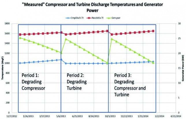

An example of such a solution is provided in which the “measured” compressor and turbine efficiencies are degrading with time. This example data is generated by using engine simulation to produce measurement data for specified combinations of compressor and turbine efficiency. The output is then used as simulated “measured” data for the data reduction solution using NPSS (Figure 2).
The measured parameters that are varying with time include compressor and turbine discharge temperatures and generator power. These measured parameters are similar to the parameters currently available to the gas turbine operator.

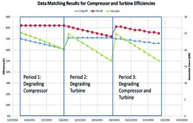

Feeding these measured parameters back into the engine performance model and adjusting the solution settings for the datamatching role, the simulation results indicate the change in compressor and turbine efficiencies necessary to match the combinations of compressor and turbine discharge temperatures for the associated generator power (Figure 3).
During Period 1, the solver correctly identifies that only the compressor efficiency is degrading. This is a common scenario and typically resolved with maintenance practices such as on-line or offline compressor washing. Depending on the number of relevant measurements available, more internal performance characteristics can be evaluated, such as performance of a section of the compressor.
During Period 2, only the turbine efficiency is degrading. This is a less likely scenario but could occur due to erosion or rub events. In Period 3, the data matching solver is able to distinguish the fact that both compressor and turbine efficiencies are degrading, resulting in the combined effect of loss of power in the generator. The solver is able to solve for multiple pairs of independent and dependent variables, which in this case include compressor and turbine discharge temperatures and compressor and turbine efficiencies.
